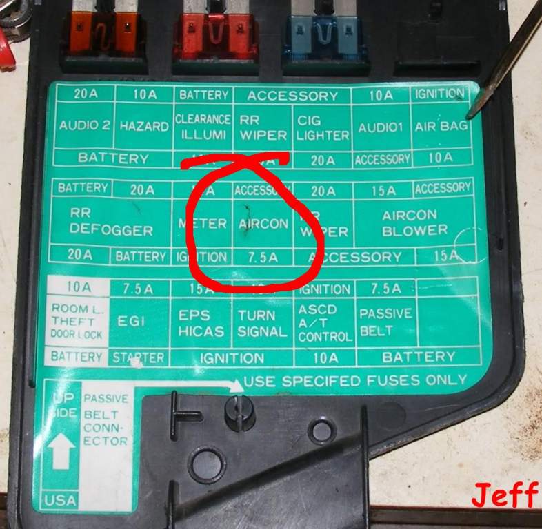

Hi folks.
The display on the HVAC does not work, the buttons light up and everything seems to function correctly but the temperature number are not present. I have replaced it with another unit but still no numbers.
Anyone had this problem?
Many thanks in advance.
If the pod is physically working, it will be the aircon ecu at fault, or the fuse to it. Check the fuses in the footwell first

Thanks again Jeff. Checked the fuse, it was ok but replaced it anyway just for shits and giggles. No change, going to replace the ecu.
I think I have an aircon cu if you're in need.

Have you tried the dash dimmer button on the other pod
