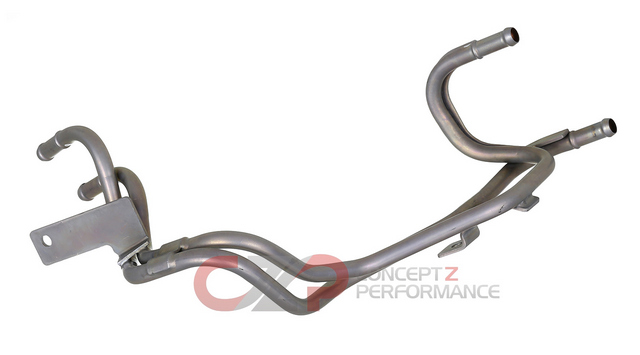

Hi I have a leak coming from oil cooler hard pipe which is positioned on left side of engine oil cooler , if your standing facing car the top hose pipe coming out of cooler on left side attached to two small hard pipes which travel and go off in different directions this is the part which is leaking , am I correct this is the oil hard lines . Is there a replacement part or fix .

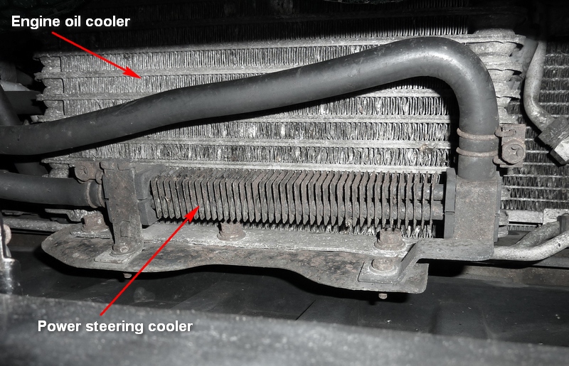

You have a UK spec car? Just to be clear which cooler are you referring too - the small finned one
at the front or the larger cooler between it and the main radiator?
[ATTACH=CONFIG]103532[/ATTACH]
Hi I have uk spec car , it's the large oil cooler , hose on top left side of large cooler if you was looking at picture,

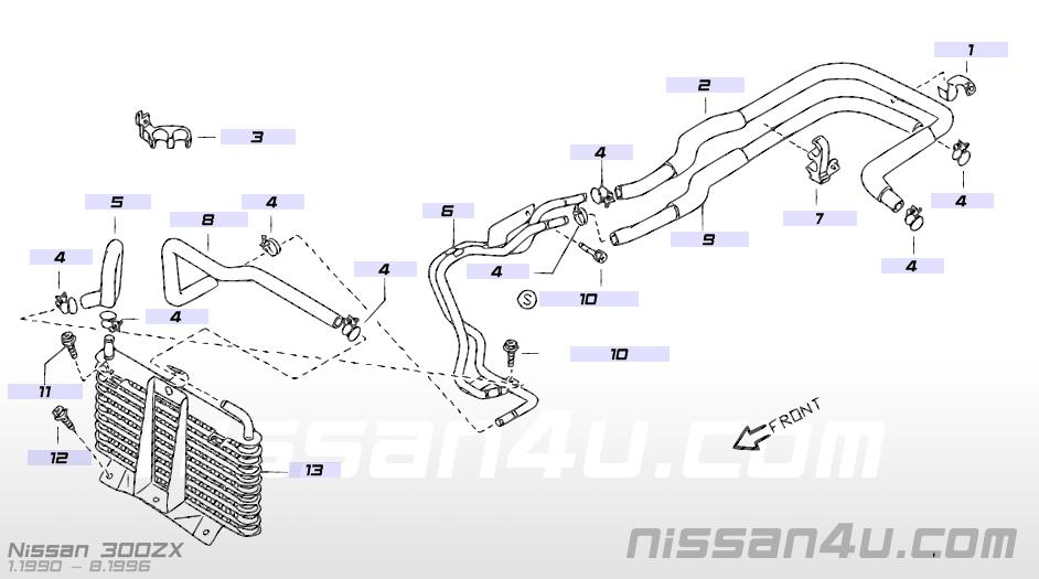

That part is generic for all JDM and UK/Euro spec TT cars. I doubt you can get it new as it shows up as NLA from Nissan:
http://nissangenuine.com/nissan/nissan-not-available-2135540p11/ (See thread re. dealer http://www.300zx.co.uk/forums/showthread.php?186491-Genuine-Nissan-Parts-in-Stoke-!!&p=1940450&viewfull=1#post1940450
We also have Mike@MJP as a trader on here, but I am not sure if he is still trading after being taken ill.

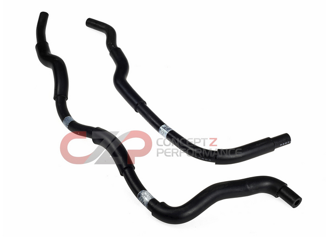

You also asked about the hoses (2 & 9) which are also NLA from Nissan, but are still showing up here:
https://conceptzperformance.com/nissan-oem-300zx-oil-cooler-hoses-long-21356-40p_p_4513.php
Try obtaining them from a TT breaker, I've posted pics of them for reference for all to see what you are after.
