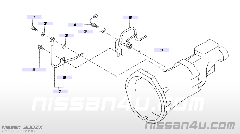

This is the complete system for UK/Euro spec manual transmission oil coolers. The UK/Euro spec transmission
cases have the part# 32101-37P00 which is likely to be for the holes for the banjo fixings 1 and 4 shown in the
second diagram below.
[ATTACH=CONFIG]103466[/ATTACH]
http://nissan4u.com/parts/300zx/el_z32/1990_1/type_1/power_train/manual_transmission_and_transaxle_and_fitting/illustration_1/
[ATTACH=CONFIG]103467[/ATTACH]
http://nissan4u.com/parts/300zx/el_z32/1990_1/type_1/power_train/transmission_case_and_clutch_release/illustration_2/
Yes, thanks for these schematics. I've seen one of them before the other is new to me. I don't really need a new case as we are prepared to drill and tap ours. We have 3 transmissions currently two of which are not 100% so we have cases to experiment with. Mainly looking for lines, hardware, cooler, pump, etc... Any real life pics would be helpful as well. The only one i've found is one with the 2 hard lines coming out of the casing holes in the trans. Haven't seen anything else.

What are the dimensions? Pics? I'd love to find the hard lines coming out of the trans as seen in the pic.
