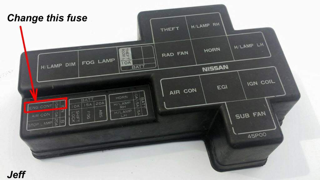

The alternator has an exciter circuit to regulate the charge rate, the fuse for this has a habit of going high resistance and will prevent the light going out and the alternator actually charging. Check out the relay and fuse box on the passenger inner wing under the bonnet, identify the "eng cont " fuse, should be a red 10 amp, change it regardless of what it looks like, as I said they can go high resistance rather than blow, so check the contact points are clean / spray with wd40.
