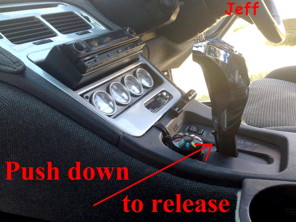

stuck on the drive in Park
Steve
Small little red lever in front of the selector ( see below ) can be pushed down to release out of park in such cases.

[ATTACH=CONFIG]102215[/ATTACH]
I wandered what the hell that was for. Nice selector, where did you get that from, very futuristic!
Just a picture I grabbed off Google not mine.
