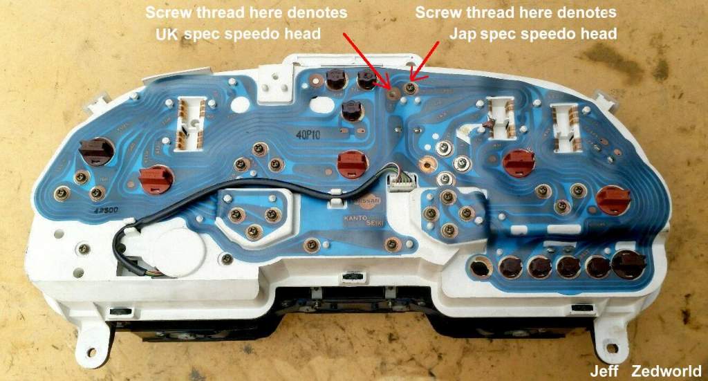

Below is some more pics of the speedo parts:

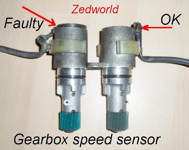

Speed sensor, ( auto type shown )
Manual gearbox speed sensor location

Not common for the speedo sensor to be the problem, usually further down the circuit, however an intermittent fault with the sensor can happen when the end piece comes adrift in the picture, this can be re fixed in place without any need to remove it from the gearbox.
On the rare occasion of needing a new speed sensor be aware there are different ones for auto and manual, and different again for non turbo and twin turbo.

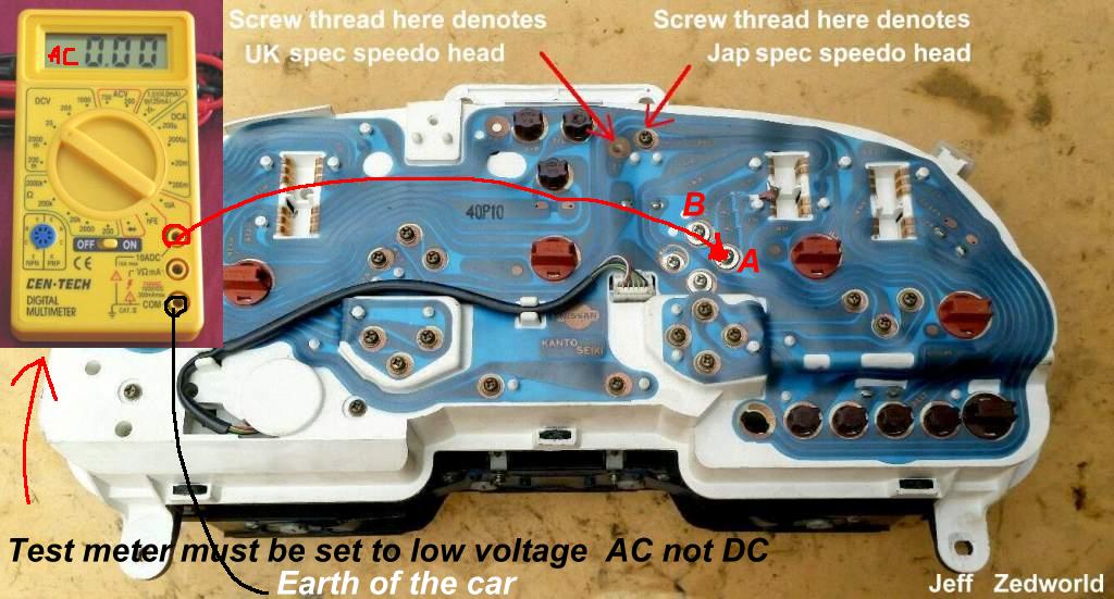

So with the voltmeter set to 12volt or less and AC not DC you earth down the black lead and use the red lead to probe screw A for speed signal input, with the engine running and the car in first gear raise the engine revs slightly and your looking for a reading of maybe 1 to 3 volts. If you get no reading at position A and assuming there is no delimter ( jap spec ) then the speed sensor in the gearbox is suspect.
If you get a speed signal at screw A then try screw B this is the output from the speedo head that feeds all the other modules such as auto box, cruise control etc. if you get no signal here then the speedo is at fault.

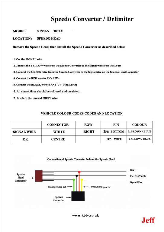

Going back to a speedo delimiter, if one is fitted it will be cut in to the A line to connector position either on the speedo track or in the loom, you will need to check either side if this to prove that part of the signal route.

Jeff....A quick question...your instructions above state using the multi meter in AC mode....just to check that isn't a typo...not doubting your knowledge...just seems to be opposite of what one would expect!
I have tried the test as above and get no signal at screw A....and also none at screw B...but I guess if there was no signal into A there wouldn't be one out at B!

Yes AC is correct, I know it seems odd but there it is, if your getting nothing at A that is the speed signal input, just check you do not have a kph to mph converter connected into the loom before the plug, if not then its a loom issue to the speed sensor or the sensor itself ( less likely ) there are connections under the car by that could be the issue.

Have already had the speed sensor out and the end isn't blown and the teeth all good....I suppose I could spin the sensor with a meter on it to see if it is generating a signal?... otherwise it must be a connection...seeing as the failure happened after a 100 yards or so over broken tarmac at 50mph!

Have removed the speed sensor and tested the voltage which I understand should be between 1-5vac....showed very high resistance of around 21...and when spinning the sensor it is very 'rough' and notchy which doesn't feel right....so have decided to replace the sensor....I have seen new ones between £45 - £150....the £45 one states it is for a TT 1995-1996....will this fit?....are there any differences between the 1990-91 and 95-96 models?

The notchy feel is correct, what your feeling is the stator moving in the field windings, as the magnets are permanent one`s, you will be inducing a magnetic field when turning it and that`s what makes it feel like that, if you connect the tester to it ans spin as best you can and get a reading then it is working ok.

SO it turned out that the speed sensor is broken, that is causing the problem.
I will order a new one.

@JeffTT Is the signal that enters the speedometer at (A) the same as the one that comes out at (B) and is sent back to the other components? Or is it processed by the speedometer's electronics?
If I connect (A) directly to (B) without going through the electronics, does this allow the other components to function?
I'm asking this because I would like to create a digital speedometer without losing options like HICAS and cruise control.
