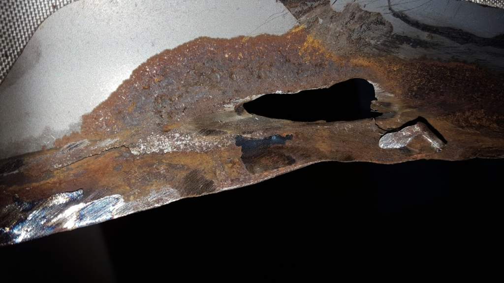

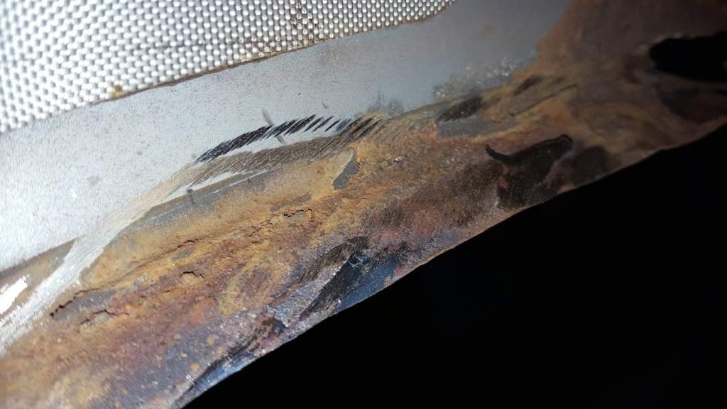

Looking inside my wheel arch it is rusted on the inside lip, your correct in saying just do the minimum
The inside has what it seems surface rust along the bottom lip i have removed the inner wing
Question is will this rust return if i rub it down and treat it?
There are a couple of other maybe inch long where it has rusted through, i would as you say prefer not to cut out a big section and just do the minimum its just the fear of the returning rust worries me
Almost certainly, it might take a while to break through new paint over the top but it will happen after a while.
