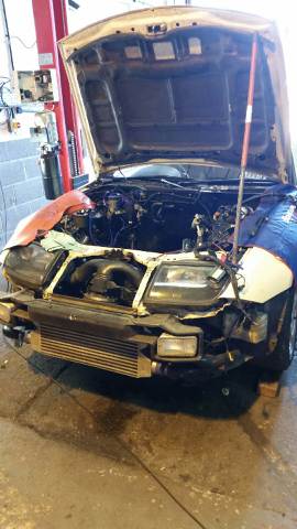

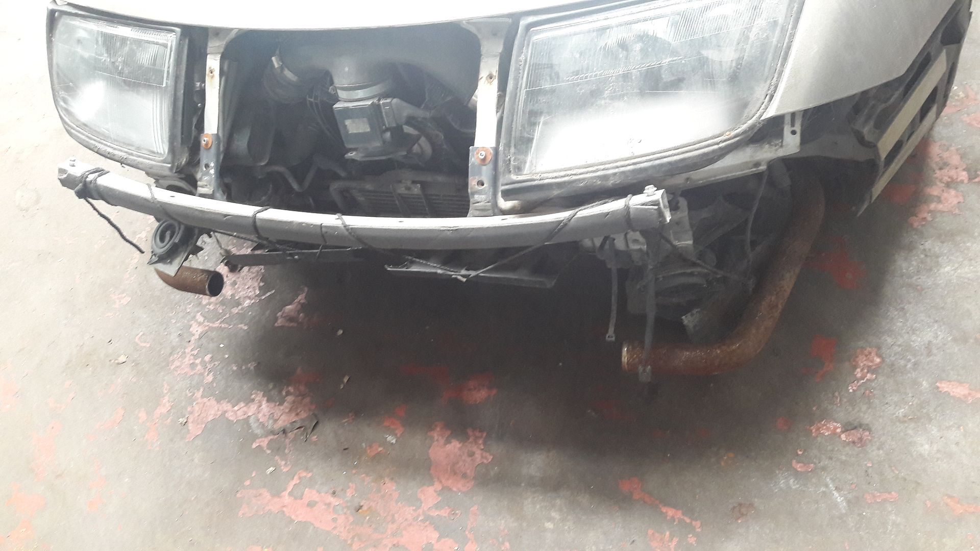

Anyone got a front mount intercooler pic with no front bumper? Ive just looked at this pic and saw its got a twin inlet and outlet but ive only got single in and out pipes unless im missing some

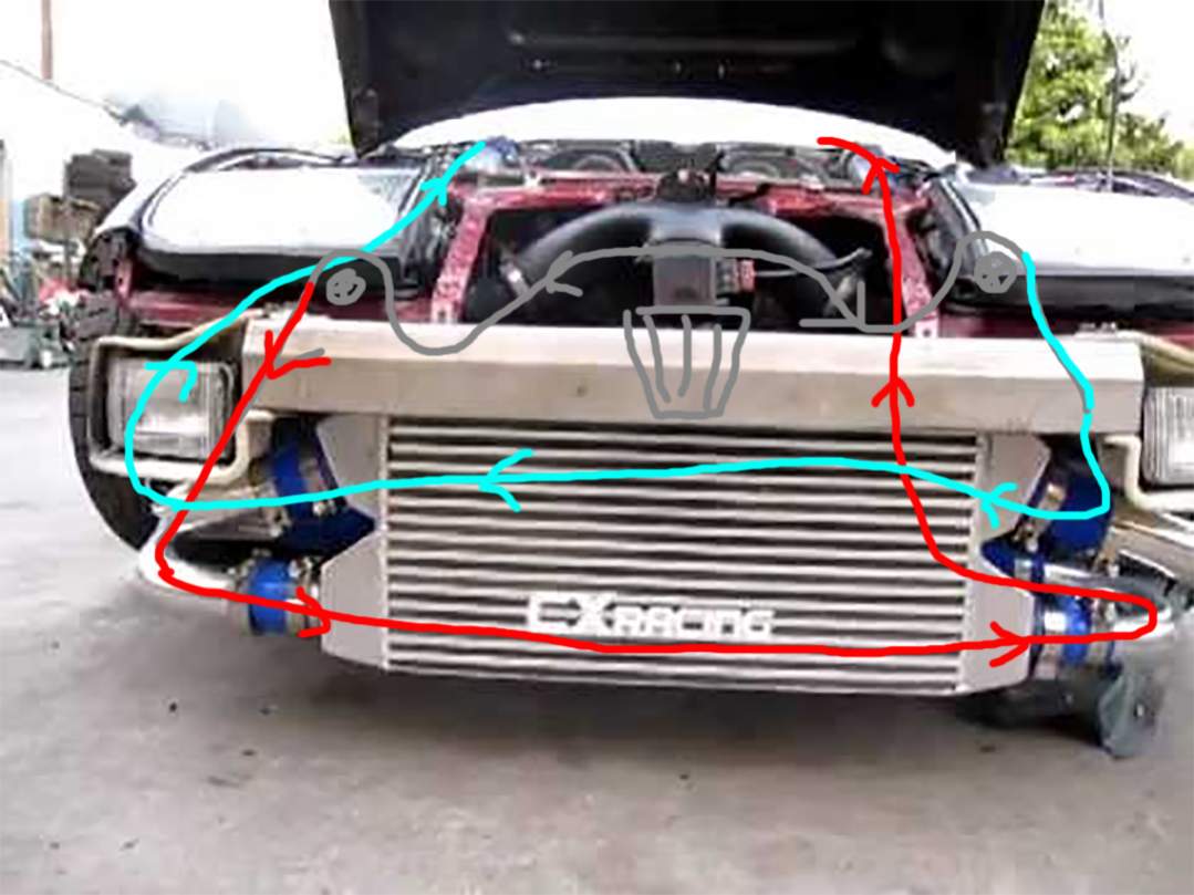

The twin inlet and outlet are because one turbo feeds the bottom, and the other feeds the top but the air flows the opposite way to each other as one pipework comes from the right and the other the left.
What do you mean by single in and out pipes? Single Intake?
Like an intercooler meant to be on a single turbo car, from looking at the front of my car i can only see 2 intercooler pipes so 2 are missing or hidden from view
This is what the piping should look like:
Intake to left turbo feeds the bottom and feeds the right throttle body (left side of engine) and vice versa.
Going by that pic i have the lower pipework definately but the upper im possibly missing ill have to check, im definatley missing all the silicone bits to connect the intercooler to the pipes
Im assuming 2.5 inch pipes is the common size used
Actually looking at it again i think i have drivers lower and passenger upper pipes ill have to have a good look around and see whats there and what isnt

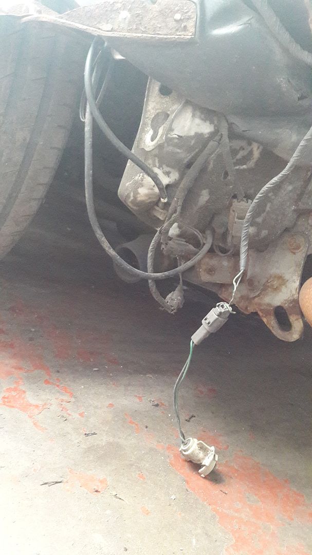

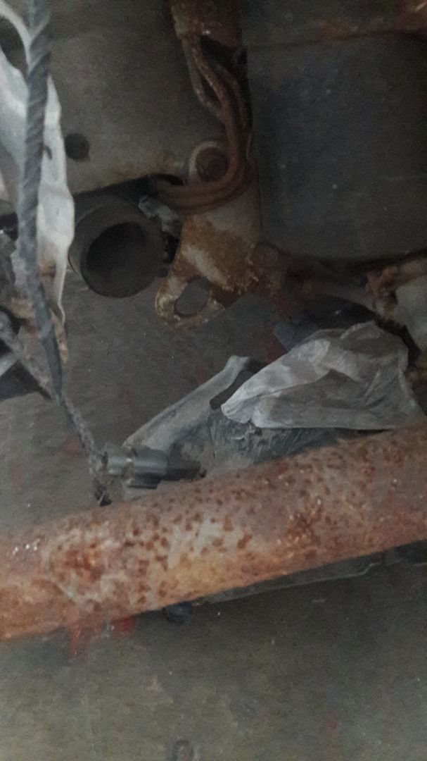

Looks like im missing a bit if pipework
Thats passenger side
Thats drivers

So you've only got those two pipes pictured on each side? Did your car come with a front mount and have you got the pipework for it?
Pics are wrong way round cant edit it so theyre right
They are the right way around but if you subscribe you can edit posts ;)
Thats the 4 pipes i have those 2 plus the 2 in the other pics, car had a front mount but when i bought it it was missing as well as the bent pipes in the other pics
