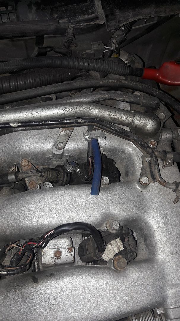

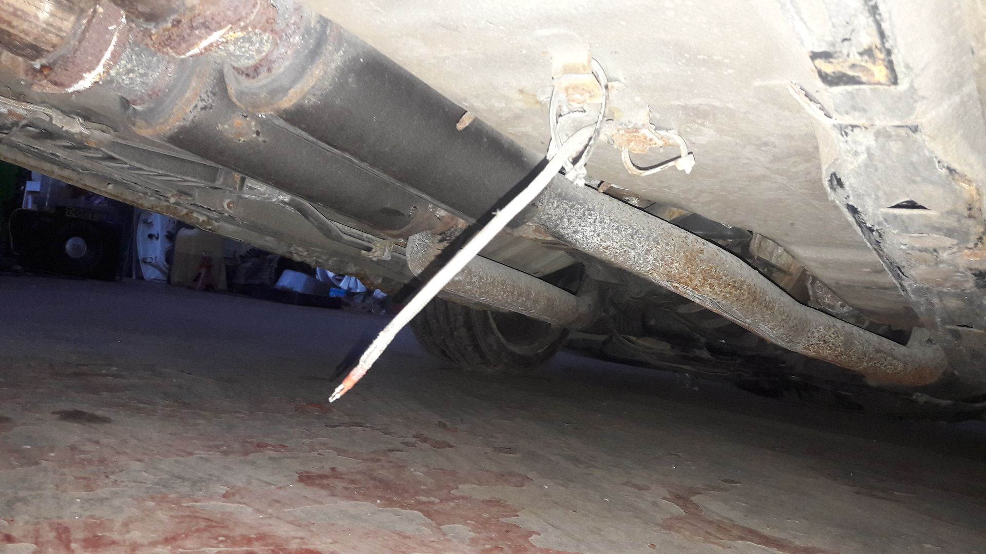

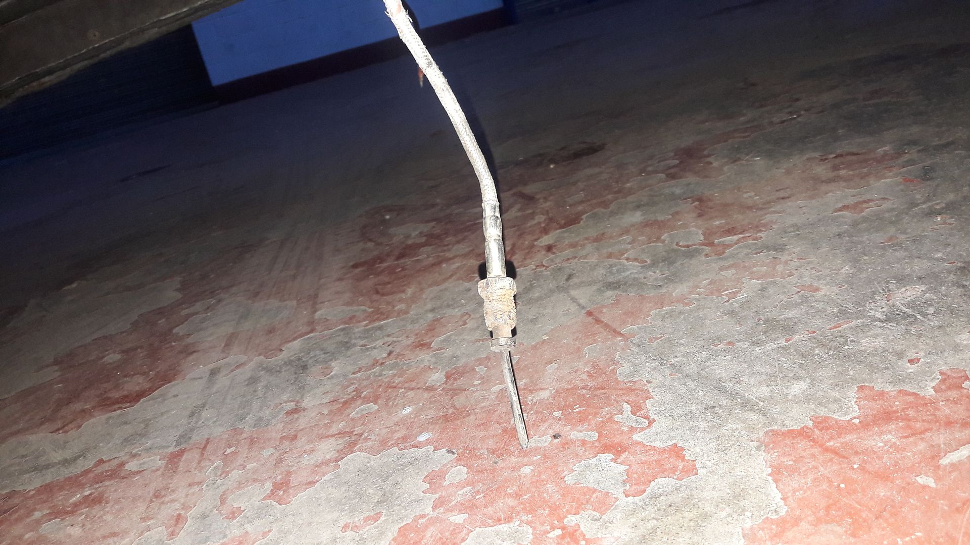

2nd and 3rd poc anyone know what they are? Handing down roughly under the front seats
Cat overheat sensors that have been removed, just cable tie up out of the way no problem

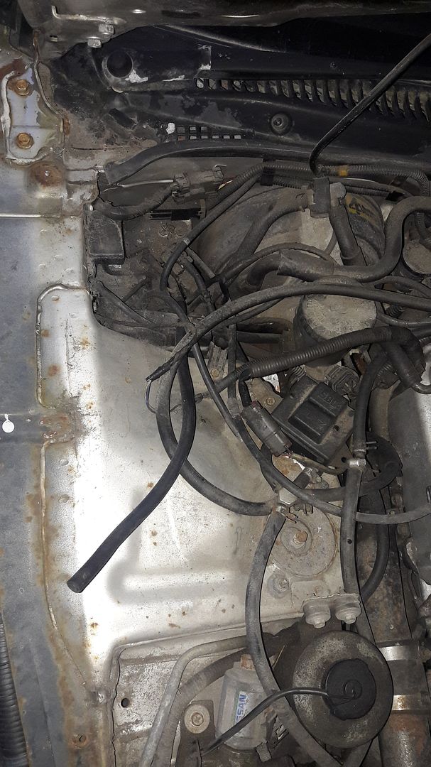

4th and 5th pic anyone know where the 2 dissconnected pipes go?
Blue pipe goes to the fuel pressure regulator below it with the worm drive clip on
The pipework on the drivers side is part of the vacuum system that looks to of been semi removed, best to finish the job off as it is not needed.

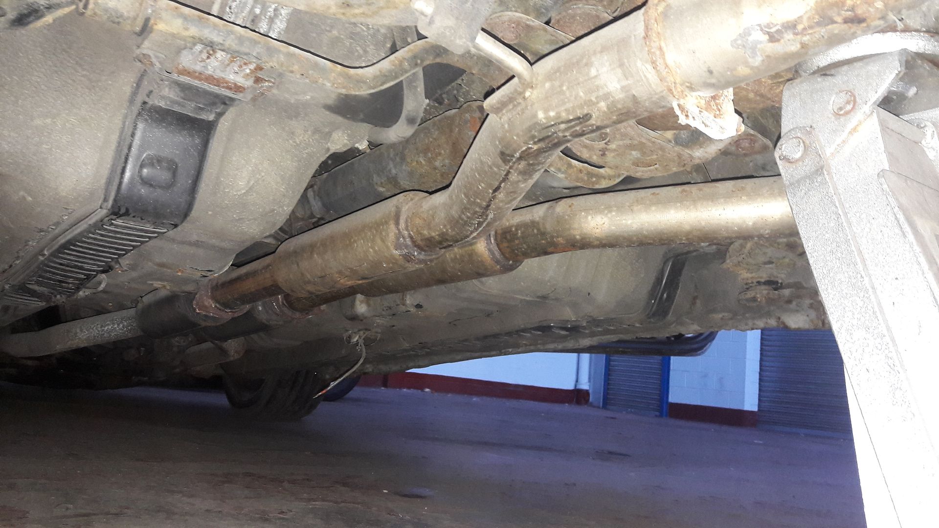

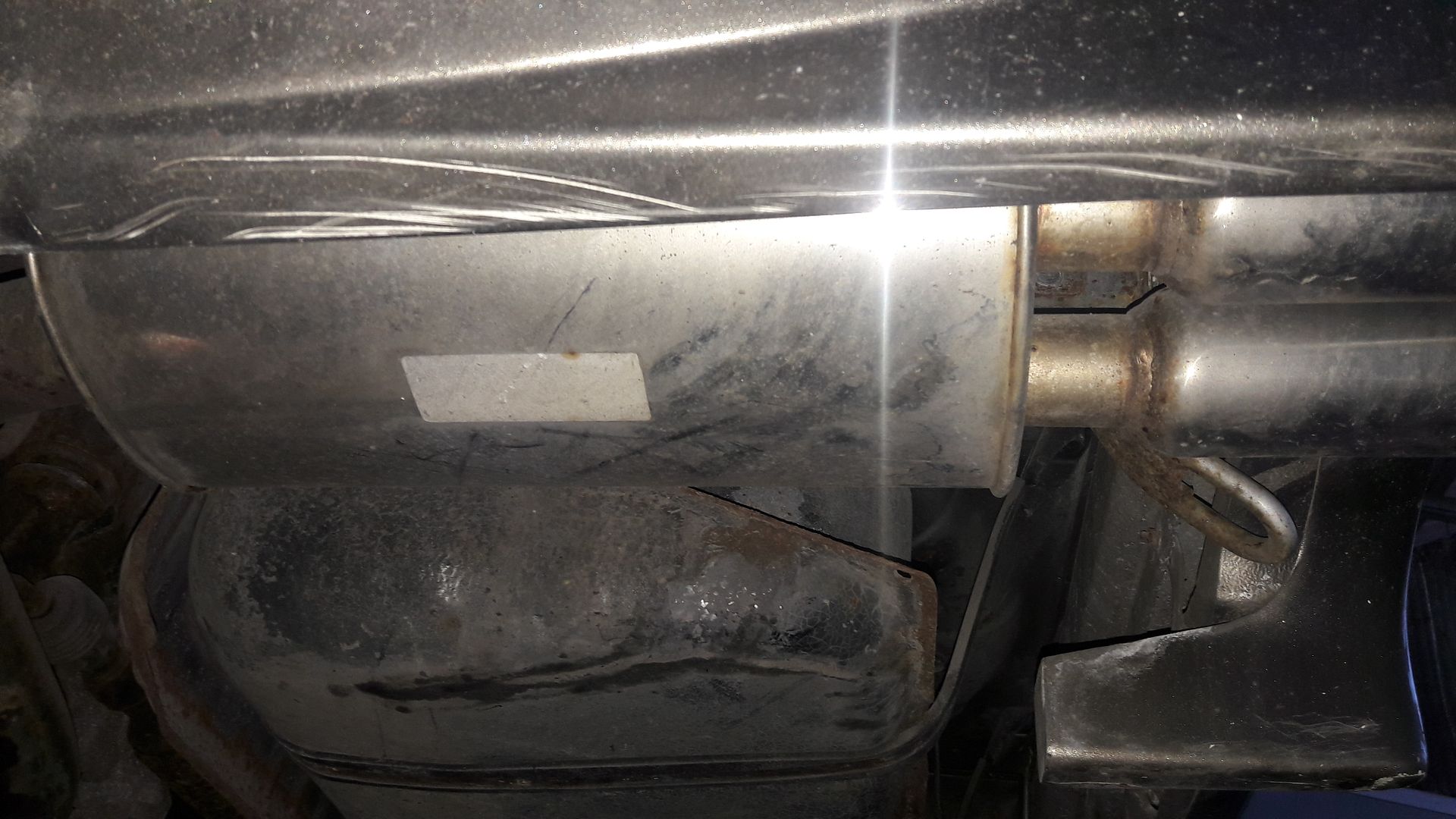

6th and 7th is this exhaust anything special or just a standard one?
Exhaust looks like a Scorpion or Mongoose

doess it look like its got cats fitted? or is it decatted?
steel wheel was fitted by me as the car only came with 3 wheels its off an almera tino, i was going to look over all the suspension in that area tonight but never got round to it its high up on the list of parts needed
Looks to be decat, that is a silencer not a cat on the downpipes.

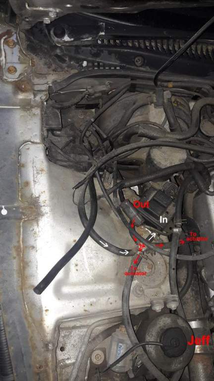

Looks like its supposed to plug into the blitz SBC id Boost solenoid, but there is a plug in the way so cant see if anything else is plugged into it. Possibly wrong but that's my hunch.
saves me a job of decatting it

I know I can see the solenoid in the engine bay, I was wondering if the vacuum line was supposed to be plugged into it though.
No Blitz boost solenoid is plumbed in correctly, see pic below have shown the pipe connections.
Jeff
[ATTACH=CONFIG]100818[/ATTACH]
Ah haha, where you have the in i thought came of the 'T' so it had me slightly confused.
