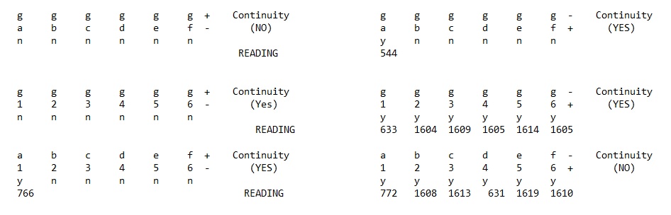

I currently have the PTU off the car and I’ve just (attempted) to check it with a multimeter, as per the online service manual (EF & EC 179). That said, I don’t know if I’ve done this correctly…
I had the PTU with the metal fins against the desk (it’s a S1 PTU) so that the numbers are visible across the back. Whereas the service manual labels the top as “g f e d c b a” reading left to right, on the back of the PTU it reads “1 2 3 4 5 6 E”. I assume they’ve use letters in the service manual to make it clear exactly what pins they are referring to when testing the continuity.
When testing the pins, instead of getting an audible beep from my multimeter, it was displaying a number ranging from about 540 to 1610. I’ll put the figures up in the same manner as the table in the service manual. If someone could tell me if my PTU is dead or if I’m just testing it wrong, I’d really appreciate it.
