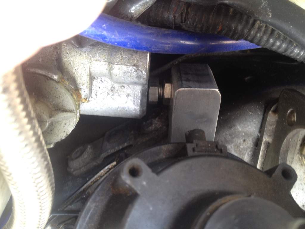

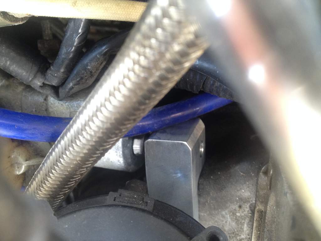

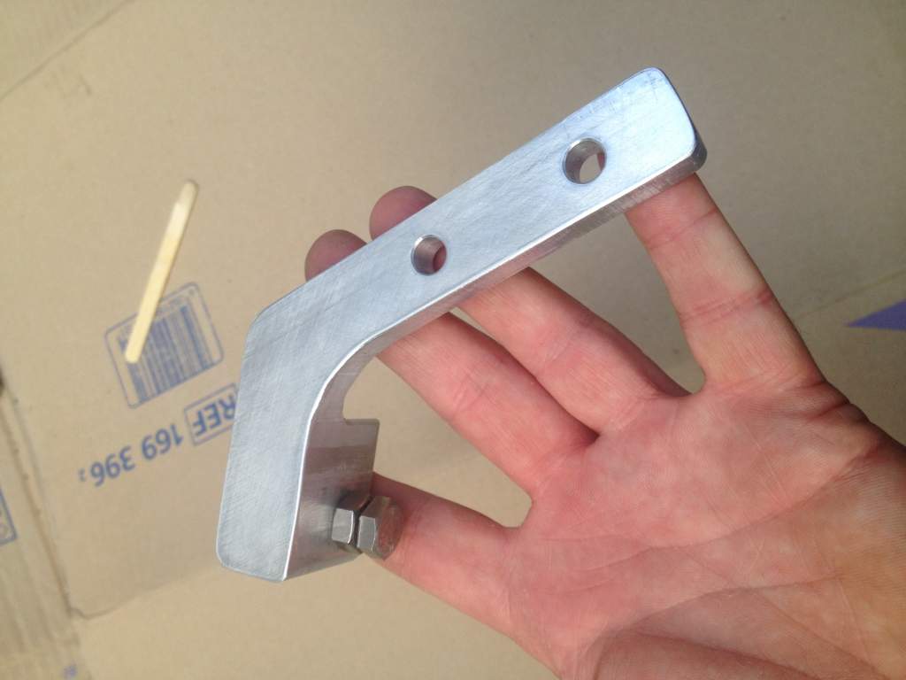

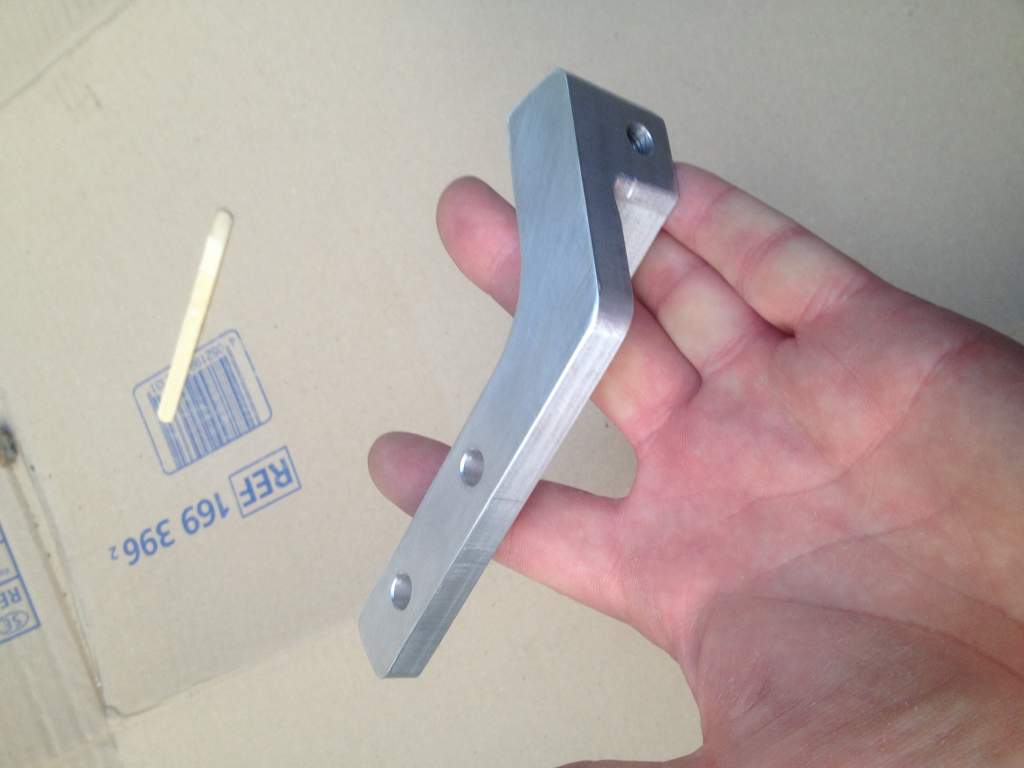

Well after a few hours of turning handles we now have this,:punk:
[ATTACH=CONFIG]100079[/ATTACH][ATTACH=CONFIG]100080[/ATTACH][ATTACH=CONFIG]100081[/ATTACH][ATTACH=CONFIG]100082[/ATTACH]:punk:

It is solid one piece machined form 30x60mm bar, all machined on my little hobby mill.

Well it turned up today and is extremely well made and fits perfectly...... Again.... Thank you soooo much for making these for us Iain.....
I definitely owe you a beer....
Thanks again....
