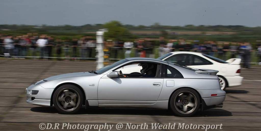

Just going to leave my favourite picture of my zed here too.
