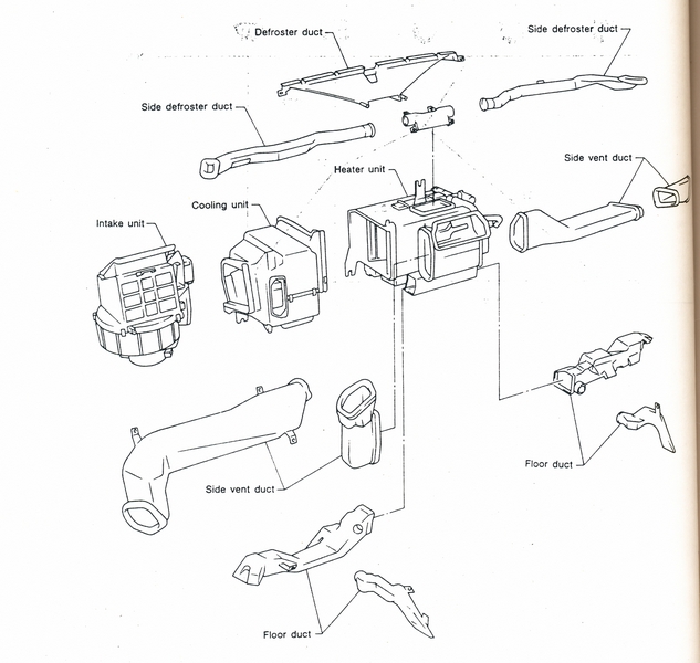

It's not that complicated to get in there. You only need to take off the panel underneath the steering wheel, held on by a few bolts at the bottom, and two in the middle I recall. The duct should be pretty obvious after that.
Edited by Alic
Some of the ducting might be either missing, dislodged or not put together correctly above the pedals.
As simple as that? I take it the pipe above the pedals goes straight to the fan?

Someone has obviously had it apart before and not put it back right. The end of the ducting was all folded in on itself, blocking the passageway.
