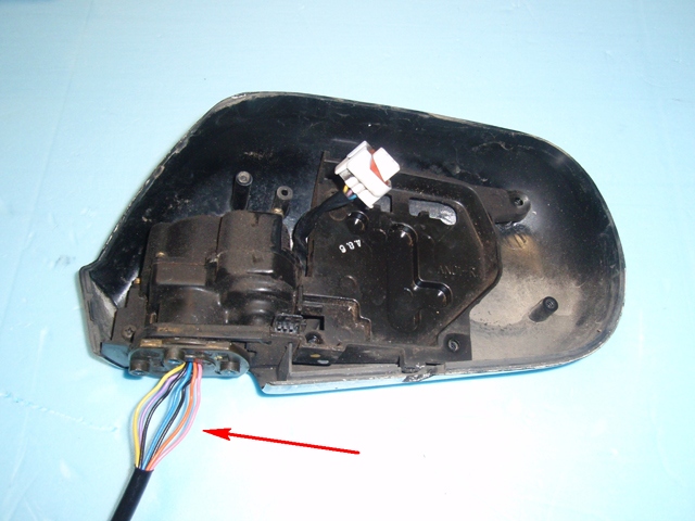

I removed the drivers wing mirror and tried to take it apart, but no luck, I've tried using my dremel on the screw, and I was going to use a oscillating tool, but even the smallest blade is going to ruin the mirror casing. I do want to get into the mirror. Really, everything I've done, and all the advice I've been given (thanks all :) )suggests the mirrors should be working, or at least doing something!! The quest continues.

These are the wiring colours and functions of the wires in the jdm mirrors themselves and are not shown in the FSM.
Mirror angle motor = Yellow, Violet, Blue
Heated mirror = Black, Black
Folding Motor = Orange, Pink

Thanks Andrew G, your post made me realise there's little point in opening up my mirrors - there isn't anything in there that's likely to be the problem.
I thought about what you said, about wiring both positive and earth, and I thought no I actually haven't done that, but everything was positive 12v (depending on the hat switch etc...), I had no earth, that's what I thought the problem was.
Then it 'clicked'! I'd like to say it was at this point I designed the flux capacitor, which is what makes time-travel possible, but no... I had accidentally wired my passenger seat motor up backwards just the other day, so the the controls on the seat were reversed - and that's what makes the wing mirror motors work - swapping from positive the negative voltage.
I wired myself up a 12v and a negative. Sure enough, swapping the positive and negative would reverse the motor. So now I just need to play with the wires, work out what goes where, I looks like the blue wire is the 'common' if that the best thing to call it.
The thing is with the folding option. I couldn't get the mirror to unfold, no motor noises, nothing, I tried applying 12v (or -12v) and one way it didn't seem to like it (on either mirror), it sparked a little, like it wasn't right.
On checking the connector pins for the folding (car side) with a multi-meter; it switches from -12v to +12v when switching the rocker, 0v is the middle. So I think everything checks out as I see it. For some reason, I think if I wire the mirrors up, they will fold / unfold - despite not doing anything when I applied power 'manually'. If they don't a fuse will blow - hopefully, I don't need things melting.

This is how the wiring goes should this happen to anyone in the future -
Annoyingly, the wires all match!! (Minus the heated mirror wired obviously) I finally realised that one pin on the smaller plug was slightly offset and not connecting (I should have noticed this before!!), so really, the only wire I needed to re-wire was the one wire -
Now, the two wires to right are for the folding motor, and these are the voltage readings going to the the motors -
Thing is, neither fold. I have to conclude that there is something up with the motors that do the folding, as they won't work. I ever temporarily wired the wires for folding into to the mirror adjust motors, just to see what would happen, and as expected the mirror moved back and forth when I toggled the rocker switch for folding. So everything suggests the mirror folding motors are somehow both dead, or not getting power at their end (as I can't open the mirrors I can't test that side).
