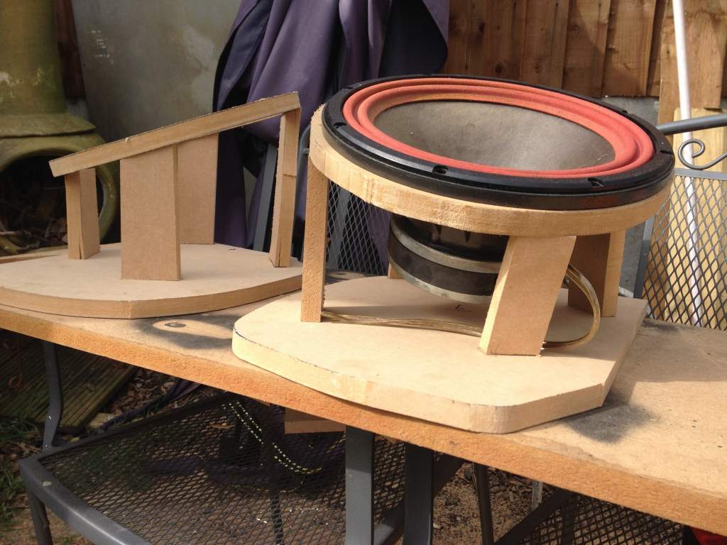

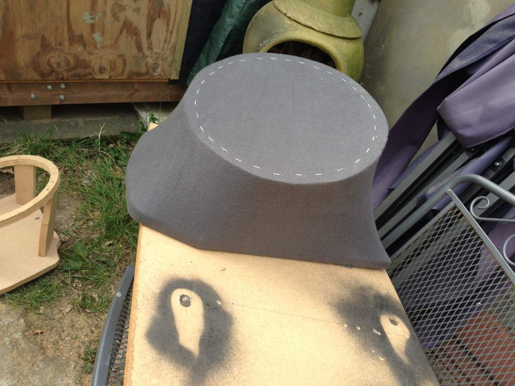

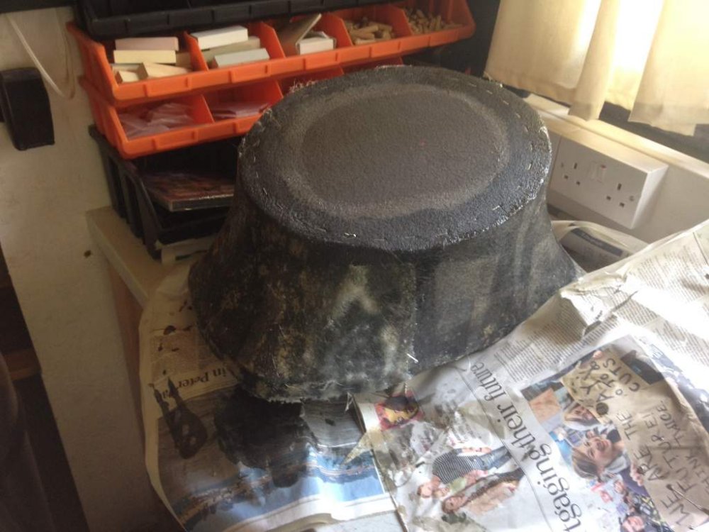

Air tight...... best way to build it is floor template, top template, use stand offs to get height and angle, then wrap in stretchy material and fibreglass resin it. Then reinforce the fibreglassed material from the inside layer upon layer, fibreglass outside with a few layers. Fleece blanket works well for the stretchy material..... and cheep to get hold of.....
Sand it and cover with matching carpet to boot area to give the oem look...
