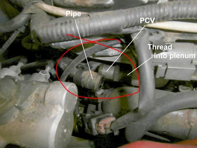

Excellent. I will leave them off. The pipe on the left was connected to my pcv valve. Was it supposed to be?
Pcv valve is large size compared to the water pipe so not sure what you mean, any more pics?
See the pic below with the large pipe disconnected from the pcv.
Jeff
Edited by JeffTT
Hang on ive confused myself. It was a coolant line from the turbo to the coolant port next to the pcv.
I cant remember what i did with the pcv pipe now as ive removed and rerouted alot. Can i leave the valves in and they not leak outwards, Pressure should hold them shut surely
