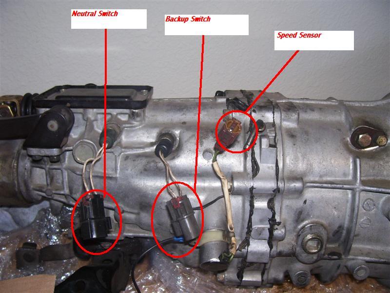

Any Nissan dealer can supply you part number: 32006-23U6A
Jeff
That looks like a black plug ?? if so ive connected mine wrong , I saw a Grey plug on the gearbox that was not connected to anything so chopped that off and connected my wires to it, then ran them into the cab for splicing into pin 44 and Earth. So could I have connected to the wrong wires, my speedo works , Reverse lights Work ( now ).
Thoughts.
Is it a UK box? they have an additional connector for the cooler pump.
Below is an import box the reverse and neutral switch connector colours can be seen.
Jeff
oh balls, ive connected to a grey plug, therefore im sure its a UK box, don't spose you have a picky of a UK box ?? either way I connected to what was a Grey plug, not a black one , so If black is the colour of ALL neutral switch plugs then that is what I did wrong,
