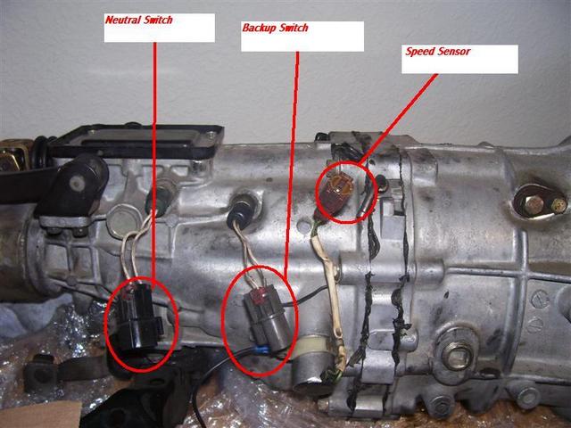

Hi Rich the speed sensor is in the gearbox and the kph convertor is the little black aftermarket box behind the dash binnacle.

Speed sensor is located on the gearbox here:
Make sure the wires going ino the sensor body are not damaged.

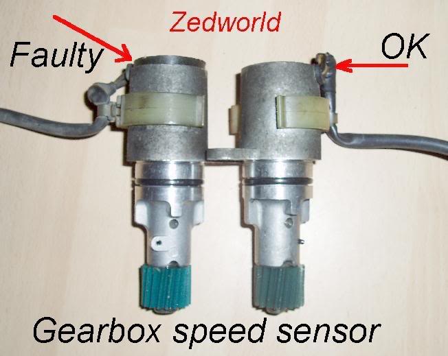

The unit is a small pulse generator, as the cog is turned by the gearbox the stator is turned within the field windings which produces a small ac voltage of around 1 to 5 volts and as the unit is very unstressed there is very little that can go wrong with it.
However the unit is held together by the black plastic end cap, this end cap is where it all goes wrong, for reasons unknown the caps start to come adrift as seen in the photo.
This loosening of the end cap allows the stator shaft / field windings to move out of line not by much but enough to stop the output been produced.
Annoyingly as the cap originally starts to slowly moves out, the shaft end float is still small enough for it to move in and out of the correct position and so causes it to work intermittently.
So armed with this information all you need to do if faced with this problem is get the car jacked up and take a look at the end cap on the sensor, if it looks like the faulty one in the picture simply apply a layer of epoxy resin to the edge of the cap and push it back in, yes that simple, no need to even remove it, and you will have one fixed sensor for a tube of glue.image.jpg

Unfortunately I still don't have this sorted. Got the car on the ramp at the garage across the road at the moment. They took the speed sensor off for me. It doesn't look like the faulty one in the pic and I tested it on an AC volt meter as advised and I read about 1.5V AC on the terminals when it is rotated by hand. So I guess that means it is OK.
