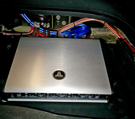

When I installed the 5 channel amp in the boot (on the right side near ABS unit) I needed 6 metres for the +12v
supply from battery for the amp power supply and 1 metre for the amp eartling. 5 metres for each audio channel
from headunit to amp (they come prepared in 5m lengths with RCA plugs). I used about 10m for wiring the door
speakers and rear speakers and about 2 meters for the subwoofer (left side of boot).
Avoid CCA (copper coated aluminum) cables for the power supplies.
