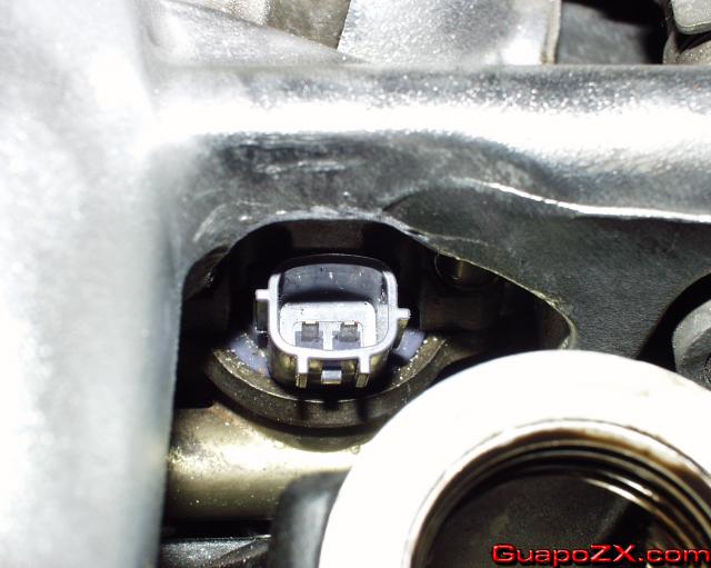

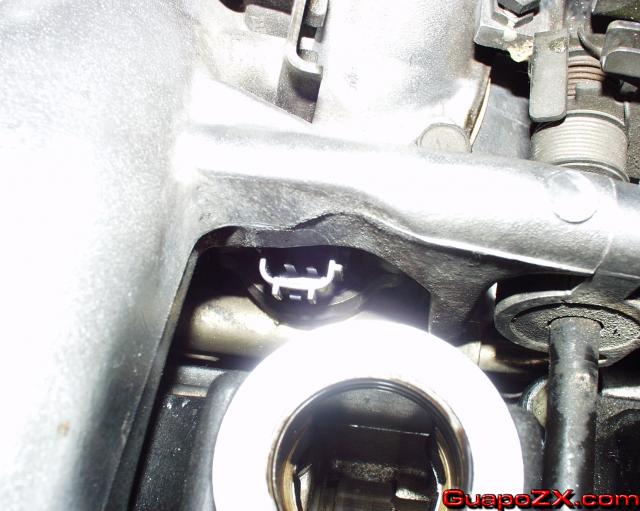

was looking to fit this rail ^ when i replace the plenum with the new powder coated one, but it say about grinding off some metal Note: If installed with an old-style upper plenum, you will need to grind away a small amount of casting above the #1 injector for the connector to clear. now i need to do this before i powder coat the plenum.
so were about and what do i need to grind off any help here would be good as i need to grind it in the morning

think it mite be this
if you get a 95 plenum the grinding isnt needed.Youll need a die grinder otherwise with a carbide bit.Thats what i use anyway.
i have a spare plenum here so a using that,yes was just reading on the later on you dont need to grind it. i think know now were i need to grind
