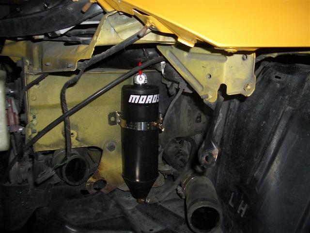

I removed and then subsequently refitted my carbon canister system (here's why):
http://www.300zx.co.uk/forums/showthread.php?172676-Refit-Carbon-Canister&highlight=carbon+canister
The coolant system is designed as a no loss system with the expansion bottle acting as an overflow and
recovery reservoir for the coolant. If you want to replace the OEM one then you could go for one of the
smaller aftermarket designs available:

Okay looks like I'm going to have to do some custom things like yourself Andrew!
In theory could you put in any overflow tank from another car? They should work the same and have the same plumbing?
Think I'm going to leave the coal canister for now as i don't know what alternatives there is to it. Thinking I'm going to try find a small a expansion tank as possible, is there anything special ill need on the tank or will any tank from any car work?
