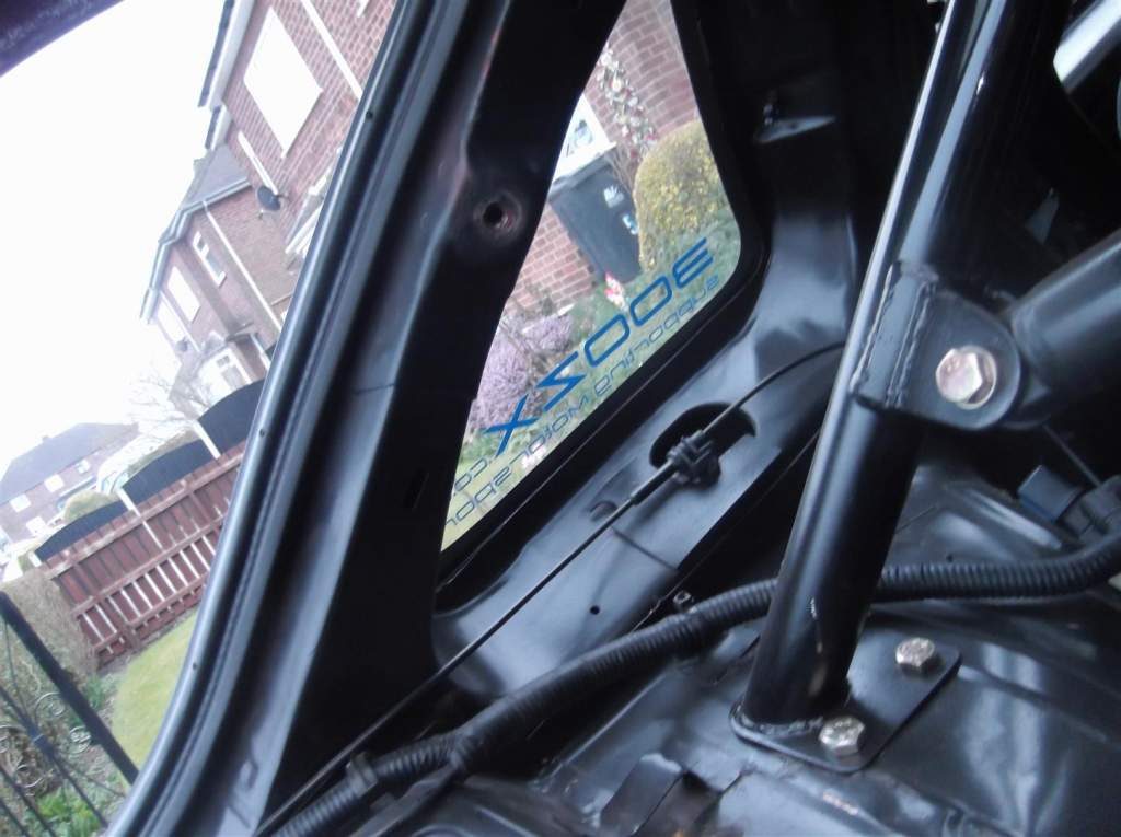

No not that bar it goes higher across back window allthough worrying it has the same part number it's of eBay . Can't post pic can someone post pic please thanks.
Struggled to get a good picture, but I think it's the upper one in this picture. 2a5c56741be4239f2cd9140d4754fa11.jpg
Yes that's the one thanks part number has UR in front of the higher bar so hope it's correct.IVe asked if it fits Swb does anyone know if there is the threaded holes in a Swb slicktop thanks.
They tell me it fits all z32 range so Swb must have threaded holes too.
Was under the impression their parts only fitted swb models, looked into them a while ago as my mates a distributor, but decided my slicktops is stiff enough
So is that threaded hole in the pillar for the boot opening gas stut then . They keep telling me it fits Swb models.
Thanks couldn't work out if pic was Swb or not.Maybe gas strut bolt holds bar tight against pillar.
Yep it is...... but I dont use the gas struts.
