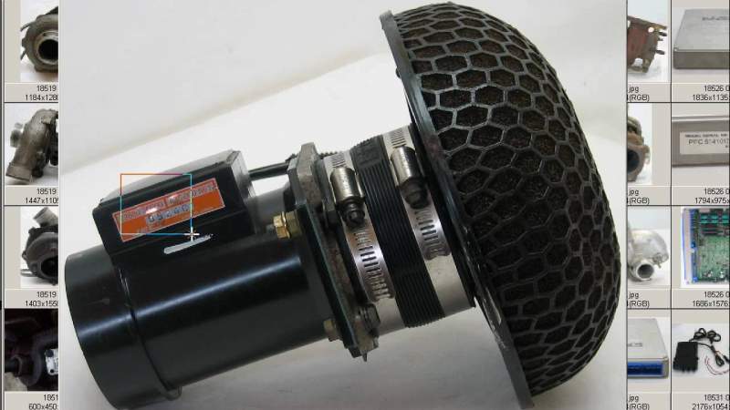

The issue is caused by the fitting of particular short filter induction kits and best option is to fabricate a shield so direct water laden air is diverted and not blown directly onto the filter when driving forward, if you have a vented front panel consider blocking it off or changing back to standard, they can cause more trouble than good when fitted in conjunction with a short induction kit.
The reason the problem occurs is the water changes the temperature of the hot air wire and thus giving false information about what air is entering the engine, the ecu trys to fuel for this and of course makes a bad job of it.
Also worth remembering, repeated events that wet the maf will cause it to fail eventually, hopefully on this occasion when it dry`s out all will be fine.
Jeff

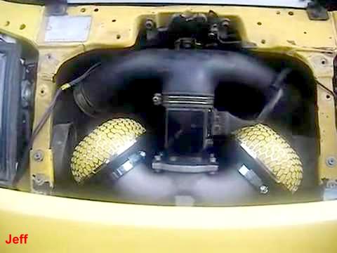

In general the twin filter induction kits do not suffer from the problem the same way as the short filter option.
Jeff

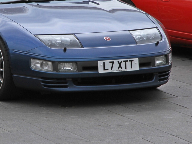

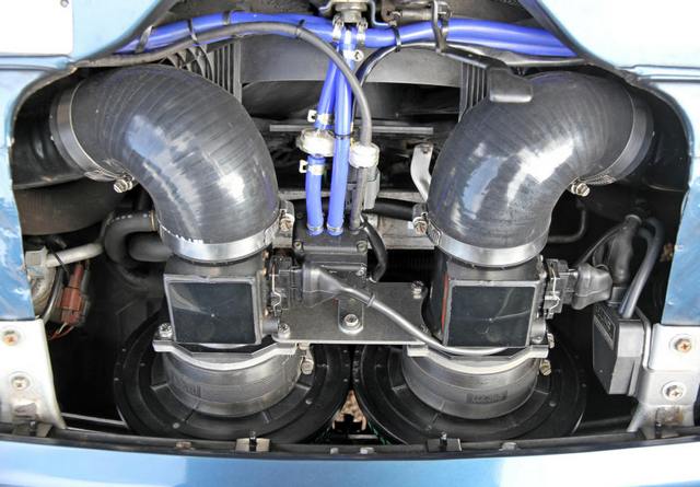

My way of dealing with the problem (now two for the dual maf setup), is have the HKS filters mounted as high
as possible behind the '89 spec bumper and the upper slot in the bumper covered by the number plate.
[ATTACH=CONFIG]93271[/ATTACH]
[ATTACH=CONFIG]93272[/ATTACH]
That's a great setup Andrew.
