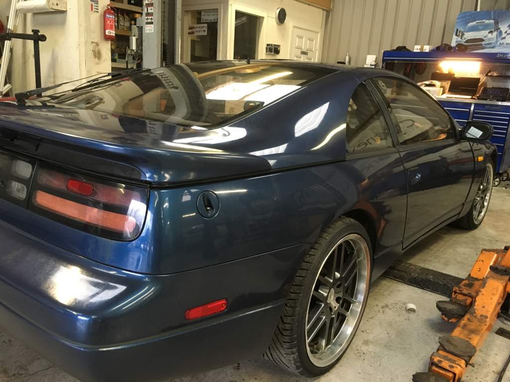

It... moves...!!!
Yay! :clap:
Had to be pushed but!! I've been reliably informed that it freewheeled very smoothly:thumbup:
I'm coming down to wash it :)
It's wrecking everyone's head about how clean it is!! I'm more concerned about if it'll ever drive again!!:scared::D, You have to push it up a slope to get it to the wash bay, I'd say the two lads were happy to let it roll down the slope to the lift:thumbup:

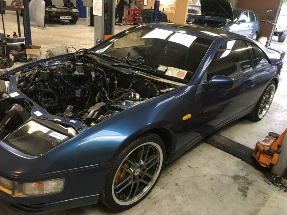

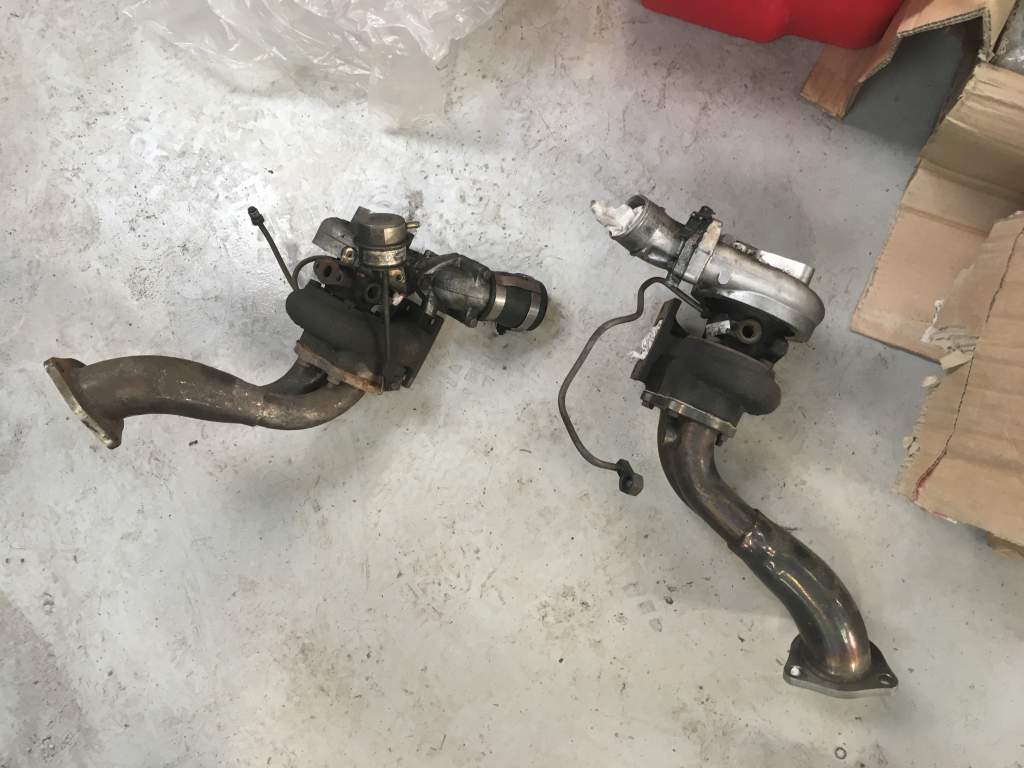

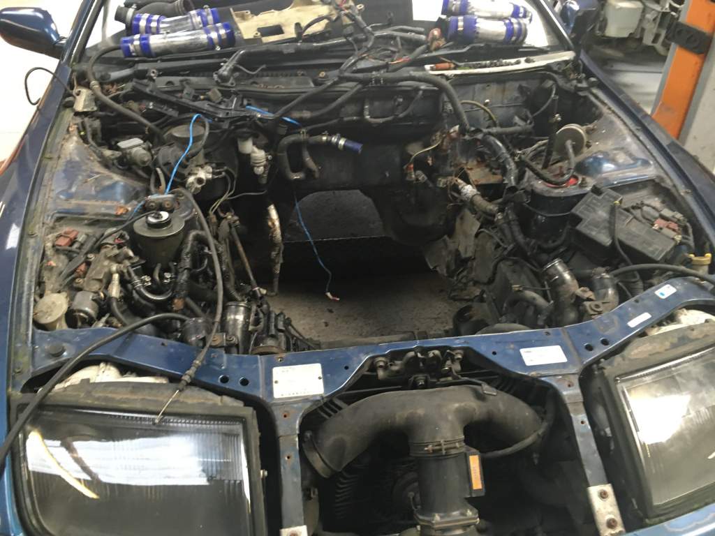

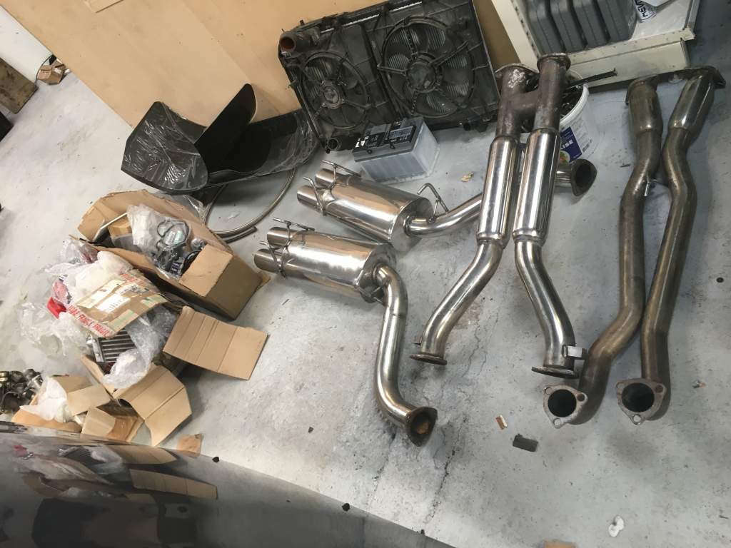

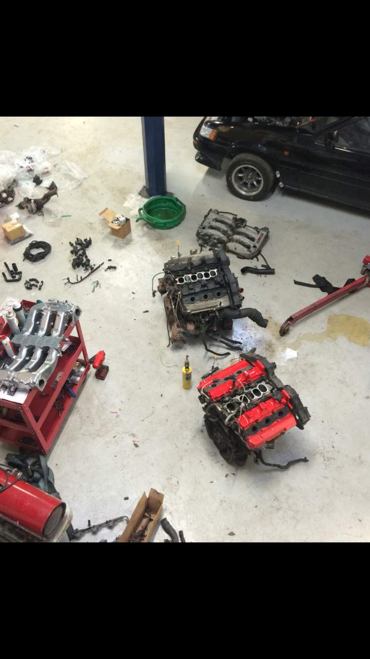

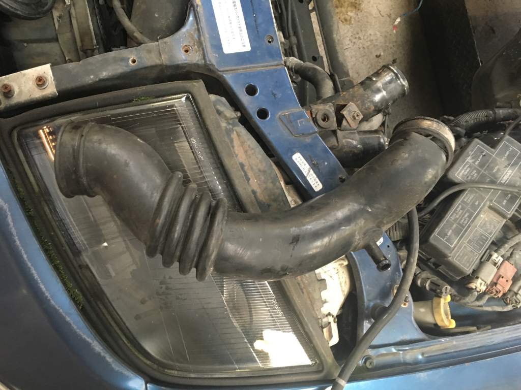

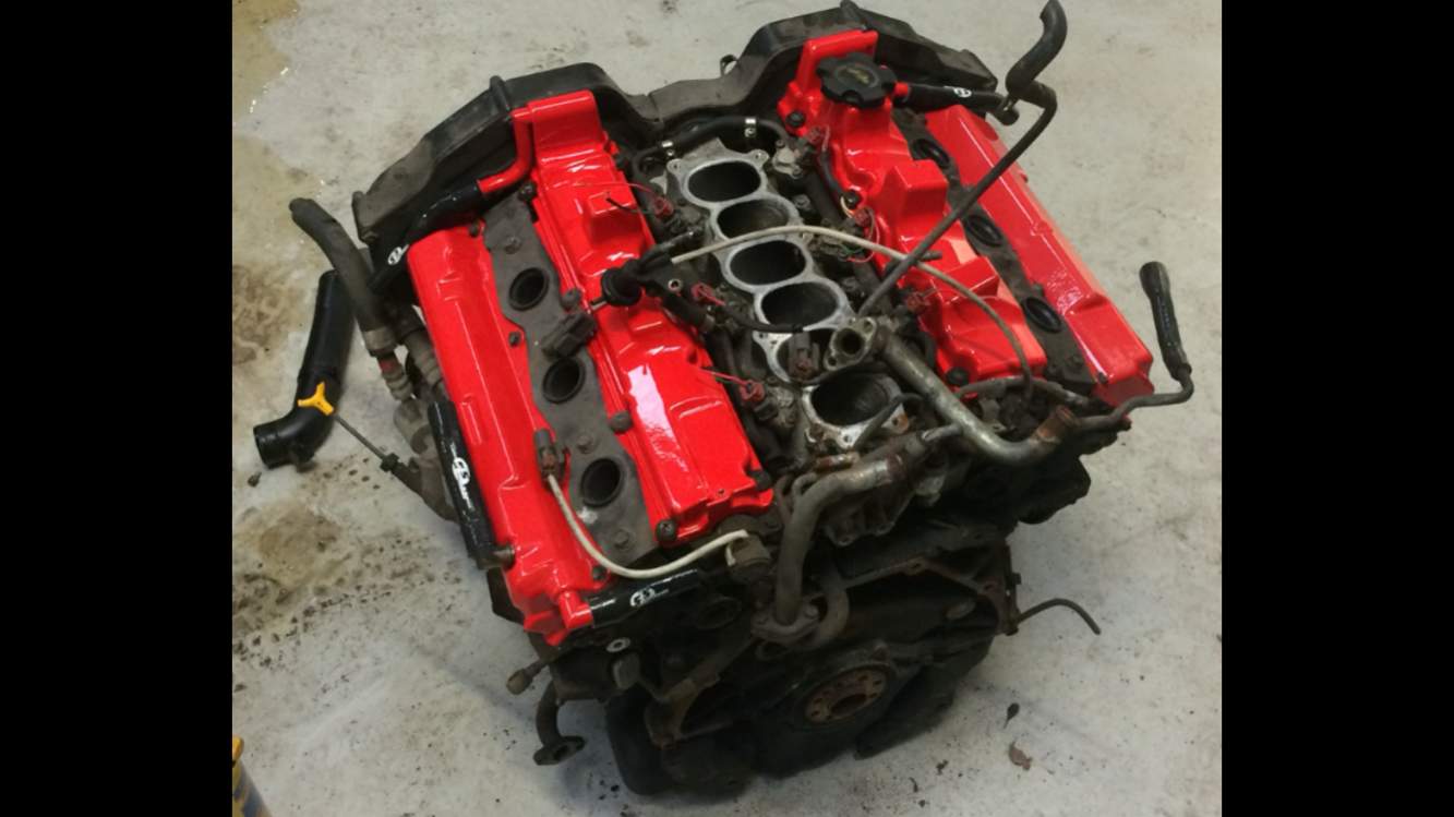

Engines out, all the bits are gathered together, most parts had only been sorted before the engine got flooded, only problem is a split accordion pipe, a water temp sensor, gaskets and bolts to be sourced for the exhaust system

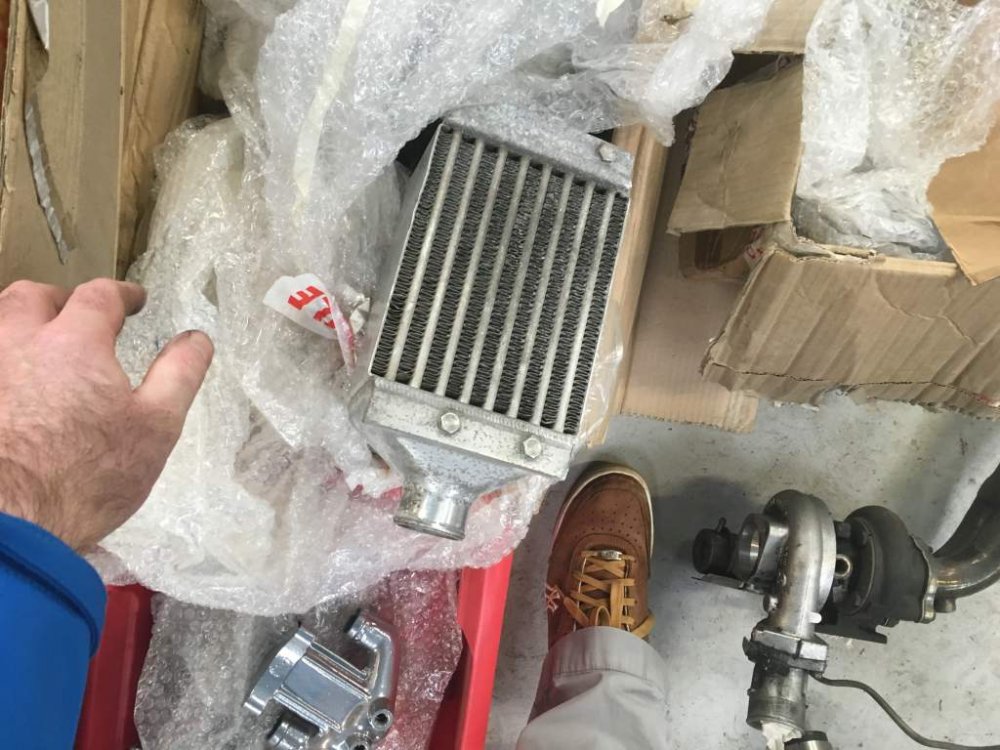

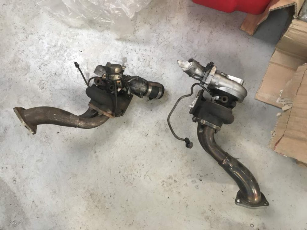

Greddy Intercoolers and rebuilt manual turbos with 360 degree bearings plus 2.5" downpipes

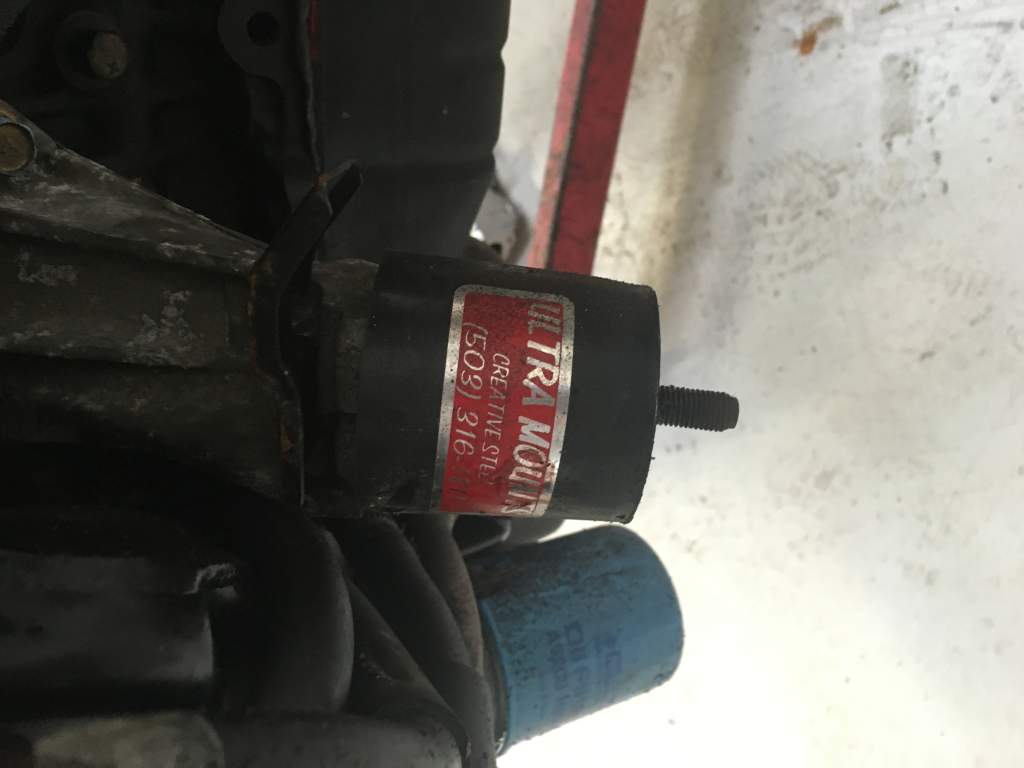

Didn't realise I had updated poly engine mounts:thumbup:
Edited by Richie K
Big thanks to Baz, who has sorted me out with a replacement accordion pipe:thumbup:
Make sure them bolts into the Greddys are sealed as they go into the open end tanks.
Thanks for the "Heads up" Joel, they're the ones that can be seen in the pics??
Yes. If you remove them, you'll see that the threaded boss goes straight into the end tank. They're common causes of boost leaks so best to wet install them with a suitable sealant.
Thanks Joel, it's good to know these things before everything is back together:thumbup1:

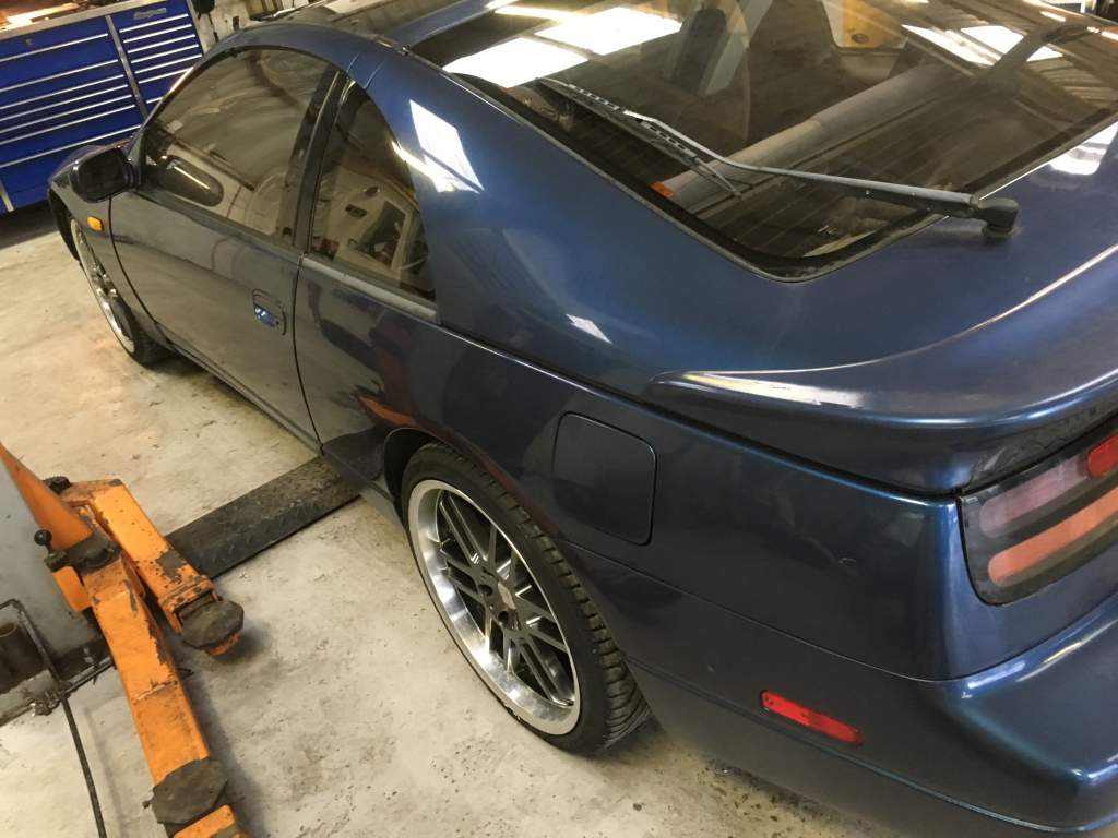

Took a spin up to the Nissan garage today, they were having trouble finding the part no. for the coolant sensor (gauge), my one was a little wobbly on top, I found the part no. on Google... €50:scared:, I noticed a link under the part no. regarding using a punch to tighten up the connector, went home and gave it a go, just saved myself €50:biggrin:

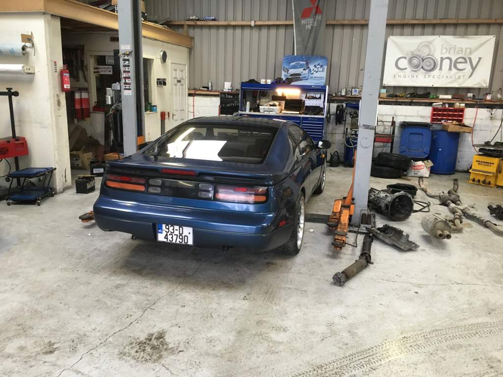

Called up to the car, as I didn't want to lose the sensor and was met with the following sights..
The lads pushed the car out and power washed it and the engine bay, I think Gaz must have been onto them:thumbup:

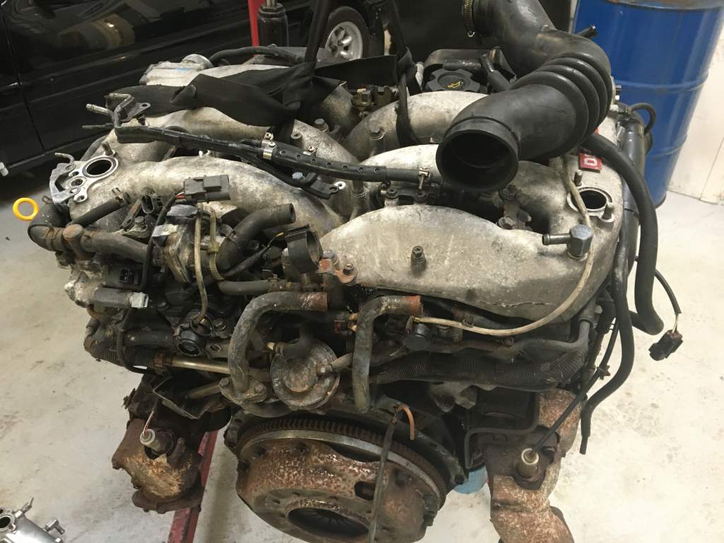

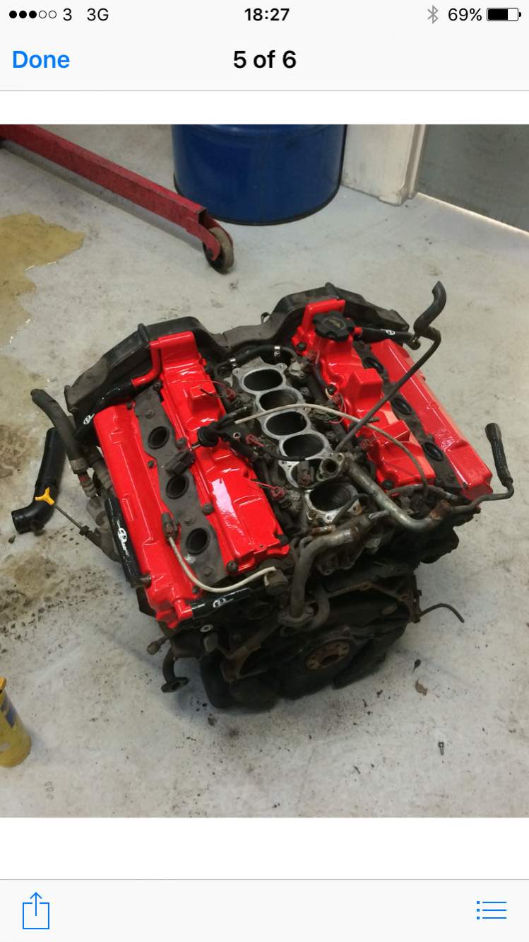

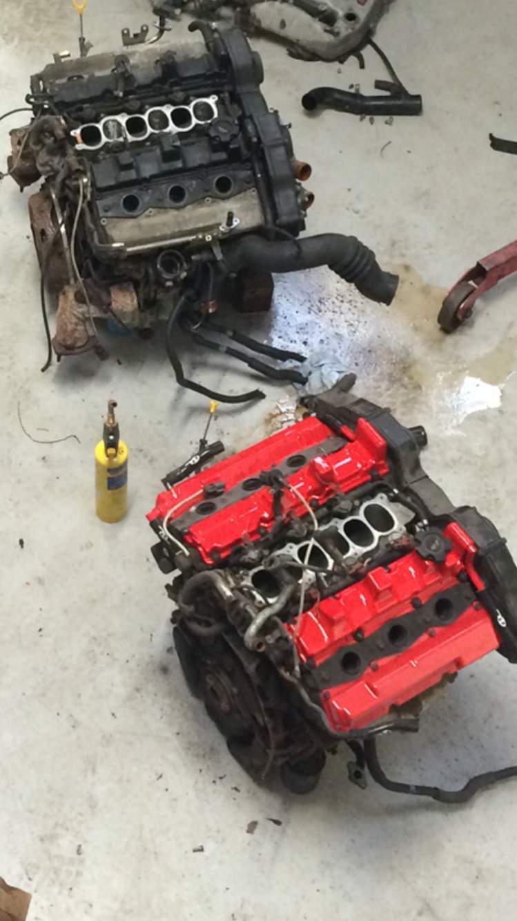

The other thing they had to show me...
Just to let you know, that's water out the old engine that's on the floor:scared::thumbdown:

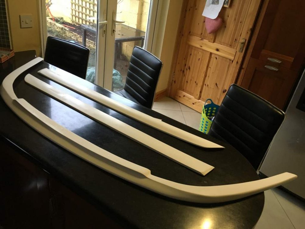

Got back home and these were waiting for me:clap:
Big thanks to Dave (Carmad) for not only sorting out my 99 spec front splitter, but I had also mentioned about maybe needing door fillers for when I ordered my Kaminari skirts, he threw them in as a bonus!!
So "Cheers Dave" :bow: You are a true gentleman and a pleasure to deal with as always.

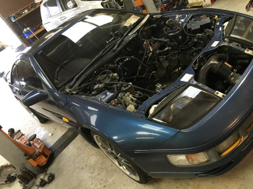

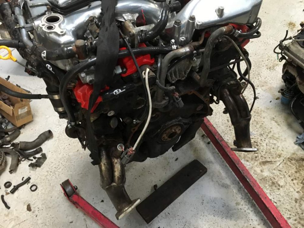

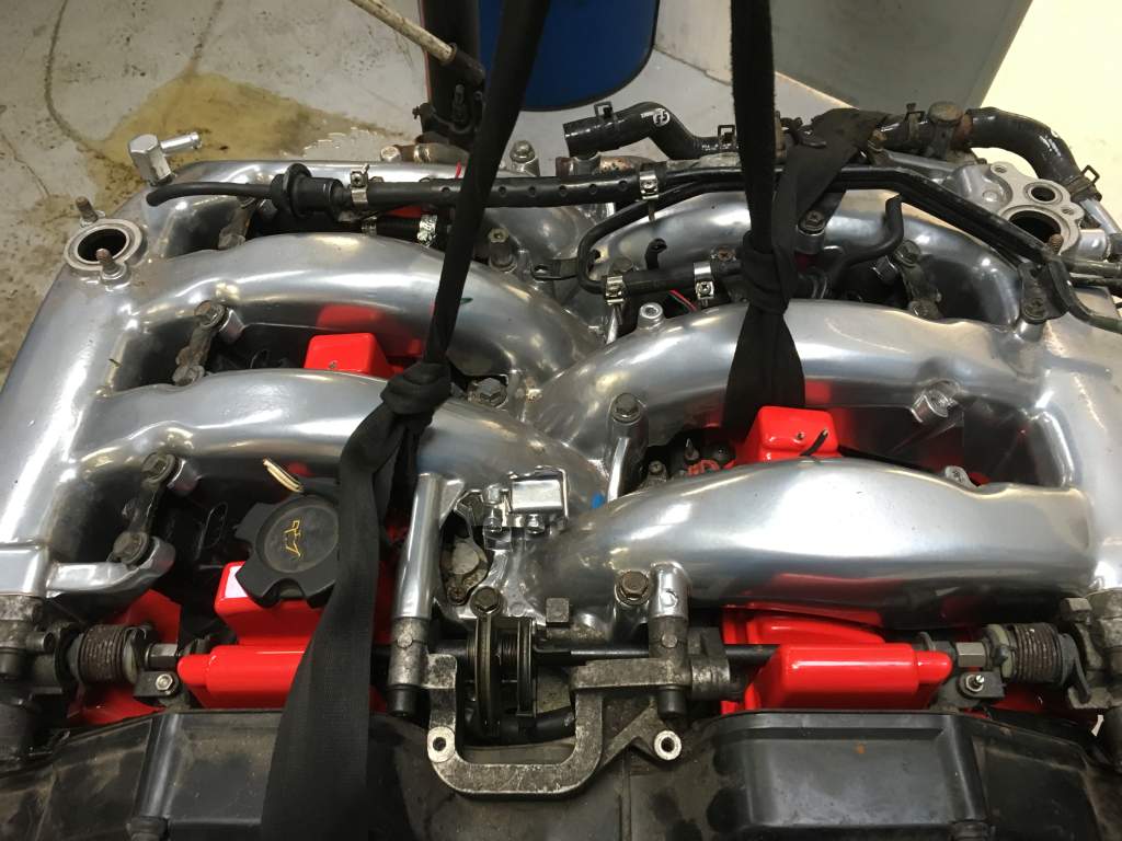

Plenum back on and Crank pulley removed to put the lightweight ones on
Plenum bypass and EGR delete completed:thumbup:

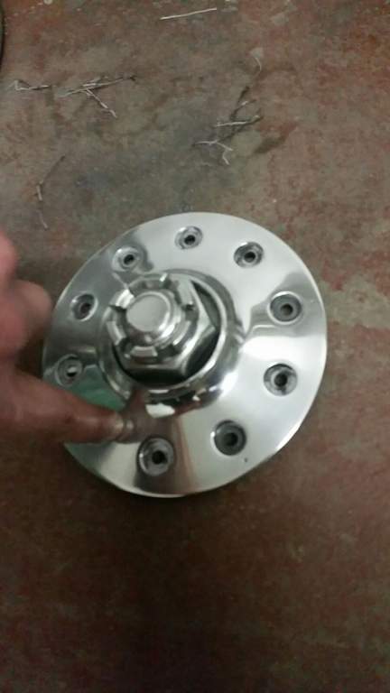

Thanks guys, Zed Mojo is well and truly back, trying to organise things to fall into place is the hard bit, 550 injectors fitted today, Wheels are being polished today, short the centre cap locking bolts, so getting those 12 next Saturday, 3" and 2.5" exhaust gaskets ordered today, should be here for Monday along with Baz's accordion pipe and Carbon fog light ducts, getting Stainless steel high tensile nuts and bolts with spring and regular washers for the exhaust system tomorrow, Cambelt change tomorrow, Wheels:hyper:

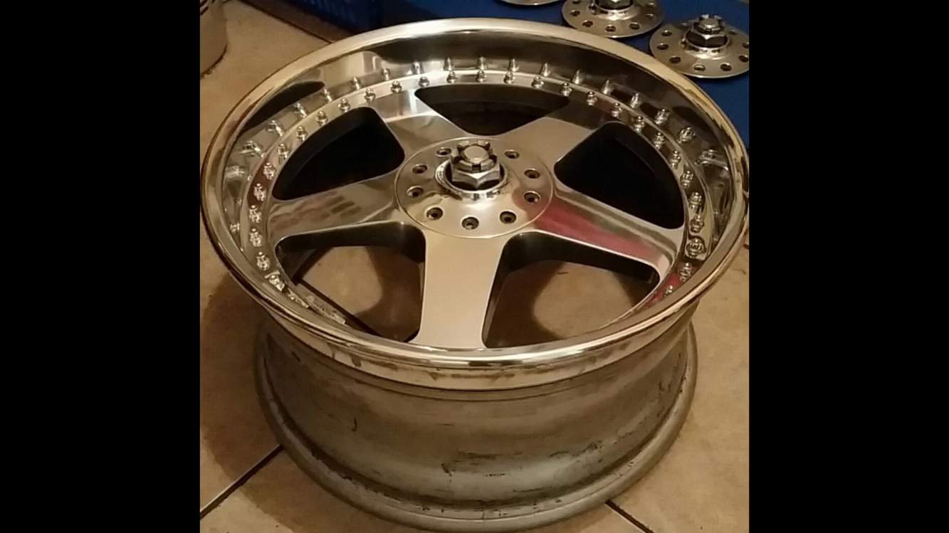

[ATTACH=CONFIG]94015[/ATTACH]
[ATTACH=CONFIG]94016[/ATTACH]
Man o man, they look lush.
Where did you say the car will be parked up once the wheels are back on??:ninja:
