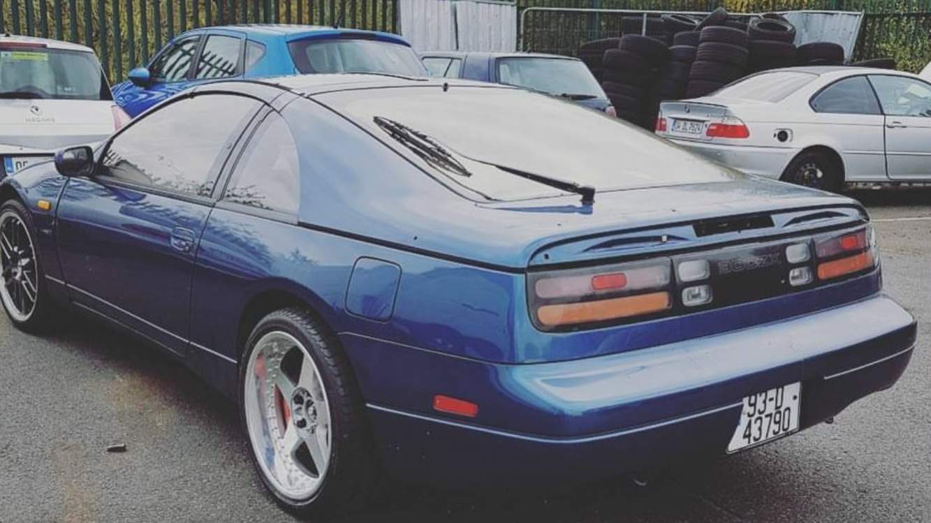

Today I had my wheel guy down, we had a look at the Volks GT7's but they wouldn't clear my calipers either!!:scared: He took a few measurements and has gone home to make a few calculations and emails to sort out my front Veilsides:thumbup:
He also took a pic of the car and applied a few filters before posting it up on his social media page, I liked the pic so much that it's now my profile pic on Facebook:punk::clap:

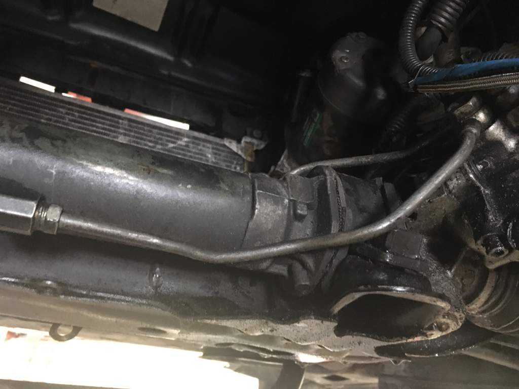

Today I got the Z back on the lift for a couple of hours, I had an issue with the back wheels scraping, so I tightened all the nuts and bolts on the rear subframe, installed the Anti roll bar only to find that my Energy Suspension bushes aren't tight to the bar??. I then moved to the front and removed my leaking power steering rack and fitted my NA one with Energy suspension bushes, pushed the car back out and no wheel rub:thumbup:

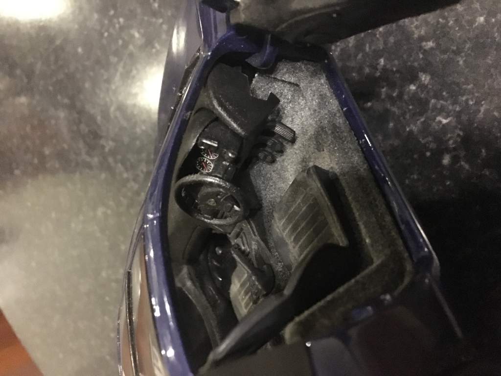

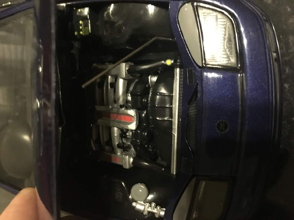

On another note, I won a Kyosho 1:18 scale 300zx model in blue, so happy days:thumbup:
[ATTACH=CONFIG]102041[/ATTACH]
Apparently these are rare enough and fetch a few quid??

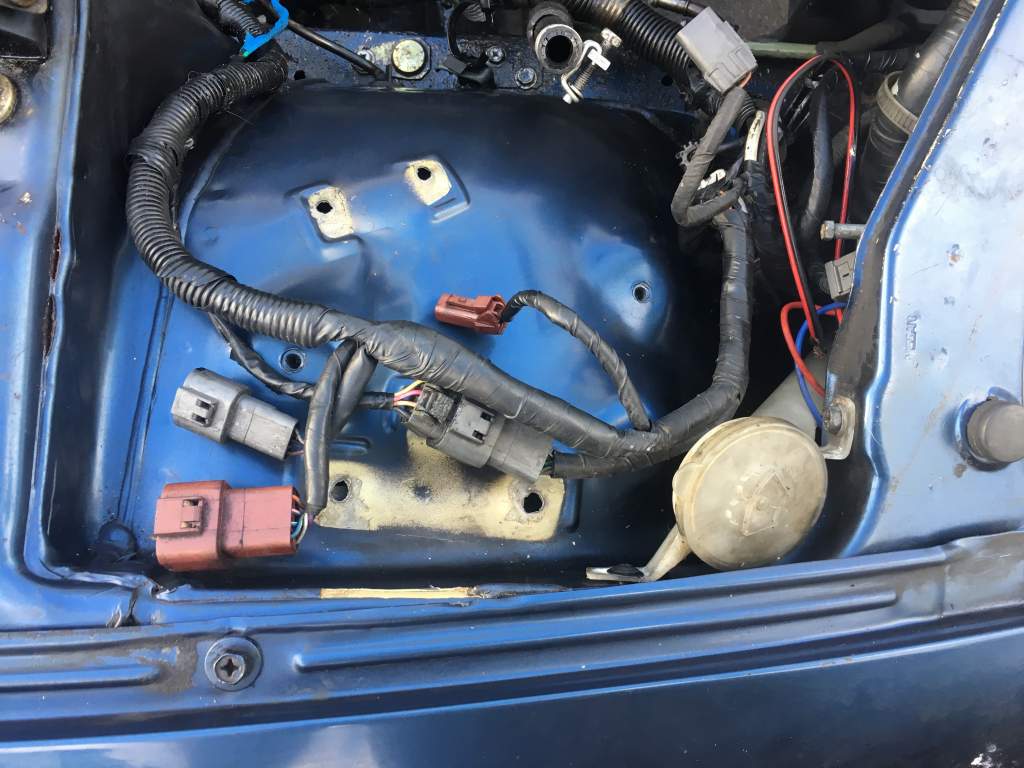

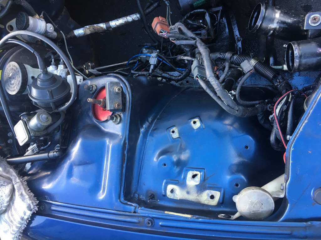

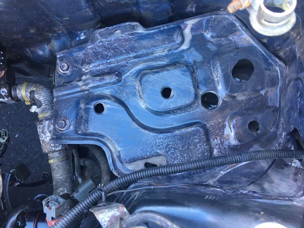

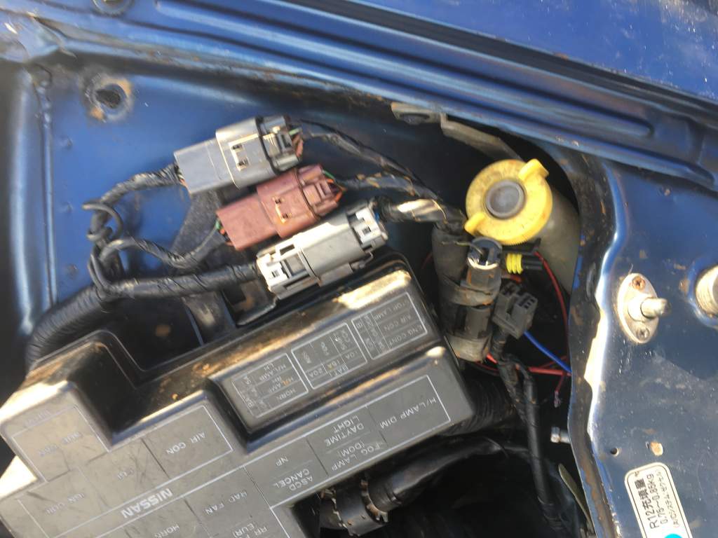

Back down at the car today, treated the battery tray with some Rust Remedy, degreased the engine bay and removed all the old HICAS mounting brackets, I'll need to fill the holes to tidy it up.
Quick question, what are these connections for and where do people move them to when decluttering the engine bay??

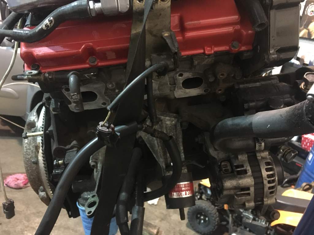

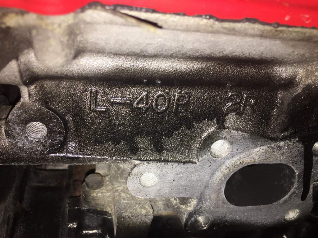

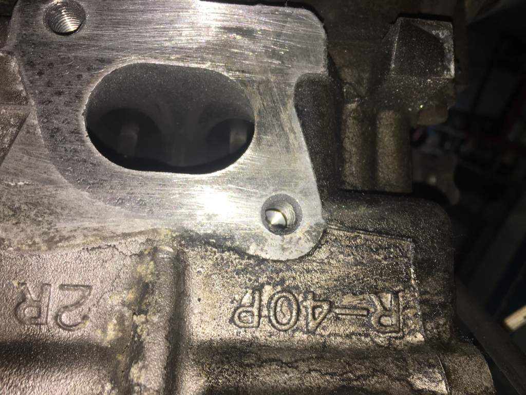

Got the manifold and drivers side turbo off, also noticed I have 40p heads, these are the good ones or are they the ones that give trouble?
Also noticed the lads had split my drivers side accordion pipe:thumbdown: anyone got one spare??
