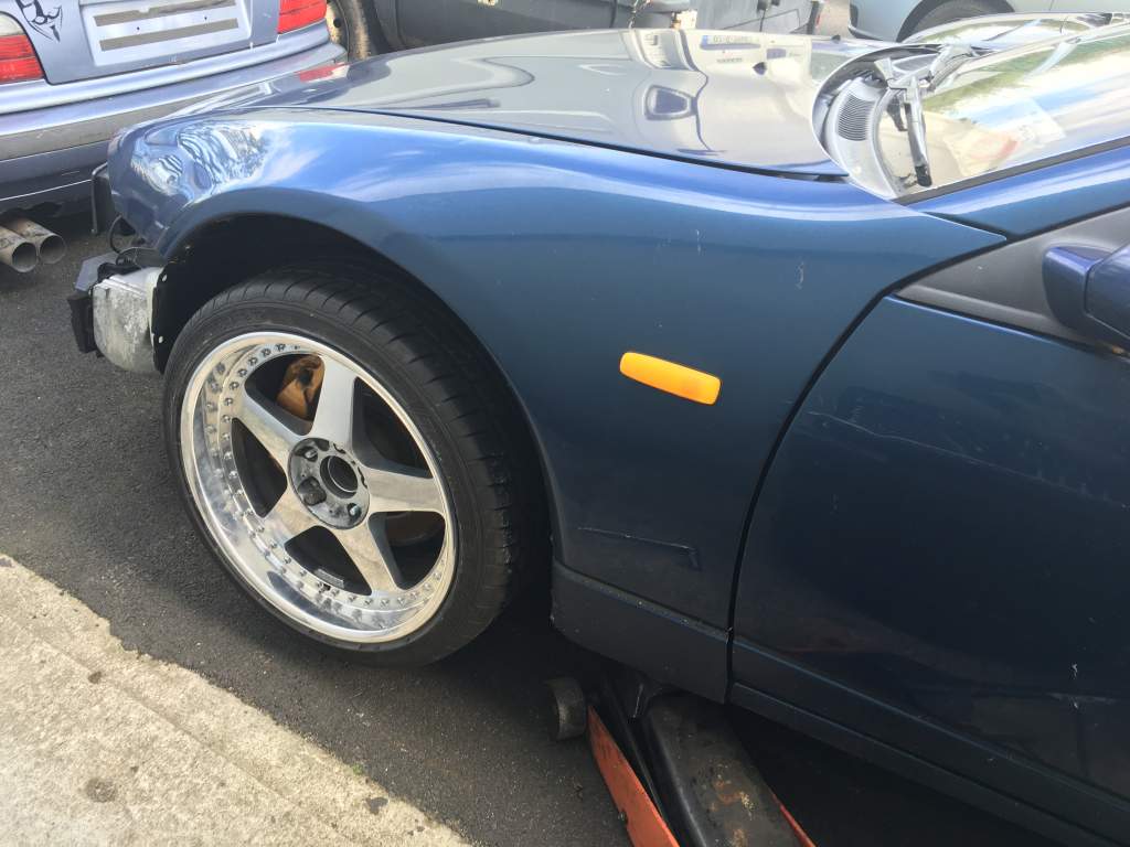

The Veilsides bud, that's the advantages of 3 piece wheels, I can change the lips and the barrels if need be to make them fit, going to cripple my finances for a while but it'll be worth it to have a nice set of wheels on the car:thumbup:
Any progress on your new wheels??
Got it, at this point that is your best option. Changing the barrels will also allow you to change the offset, therefore eliminating the need of spacers.

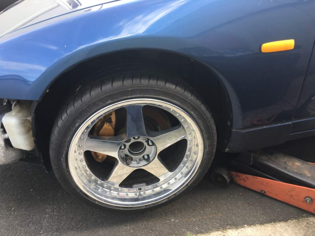

I will still need spacers as the spokes are too flat, so no matter where they are positioned in the barrel they will always catch the calipers unless spaced out

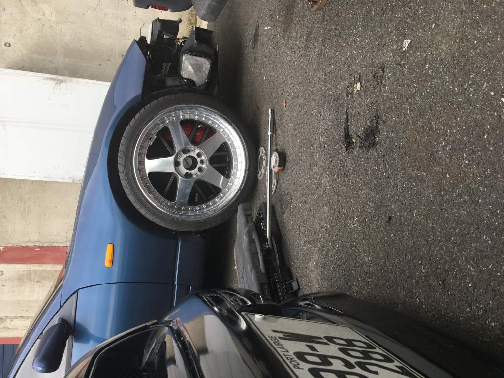

Fitted both sides with 25mm spacers and got both sides fitted up with my 355mm discs / Brembo's. I've to wait two week before my wheel guy can get down and take the required measurements to sort out my front wheels.
Needed the spacers to clear the existing Big Brembo let alone my 6 piston ones
Hoping they don't stick out too much:innocent:

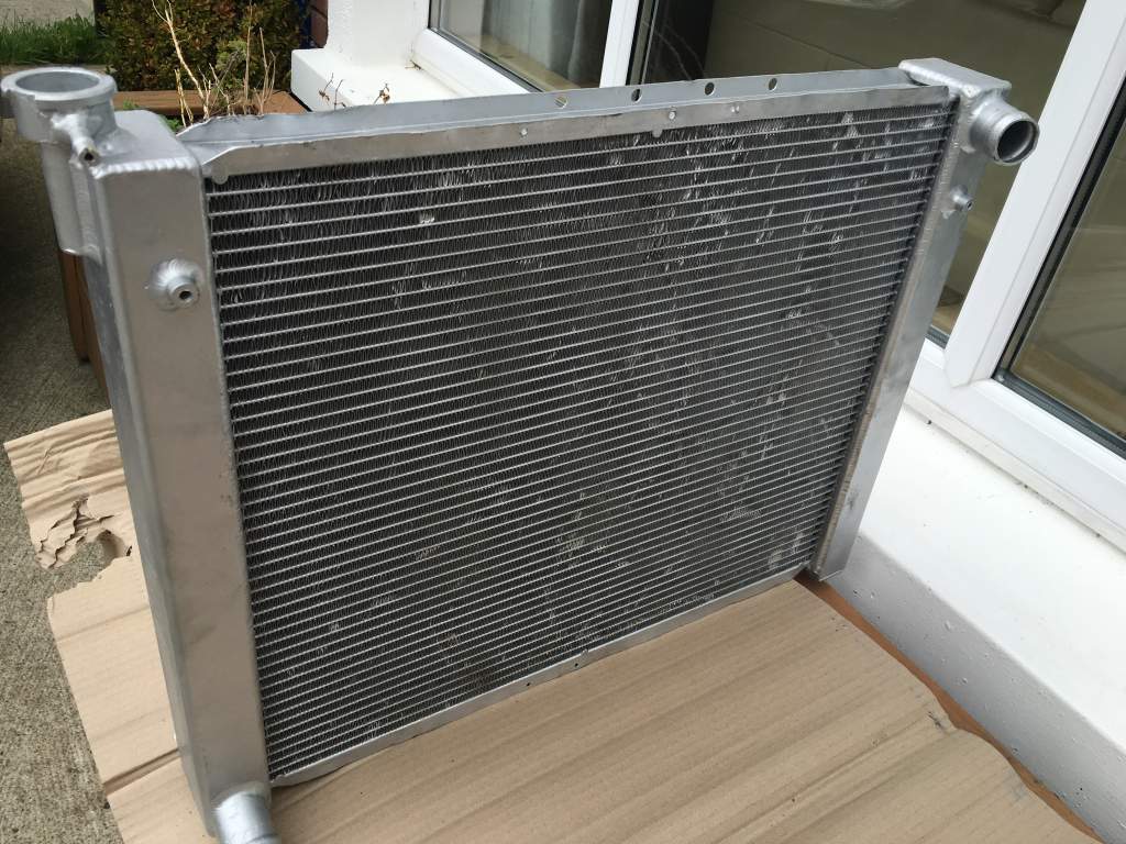

So today, I pulled my Koyo Racing Rad, I had previously broken the overflow pipe on the filler neck by closing the bonnet with the stay, snapping it. It also was a bit warped from lying in a box in the shed for 5-7 years. It's now gone for repair, should hopefully have it back by Thursday. €140:thumbdown:

Koyo Racing Rad fully tested, straightened and repaired, all ready to go back into the car:thumbup:

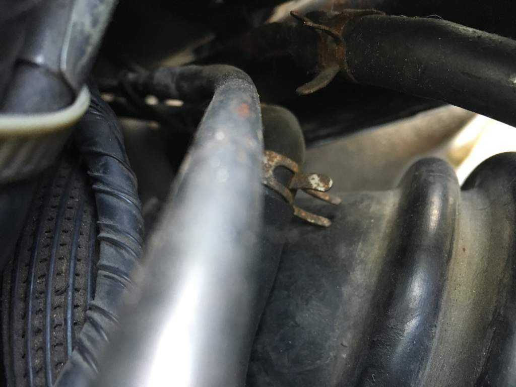

What's this pipe here for?? Carbon canister??
It's beside the passenger side recirc pipe

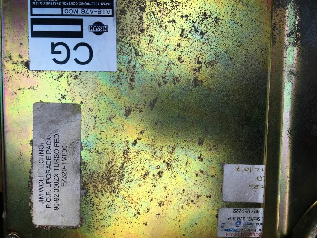

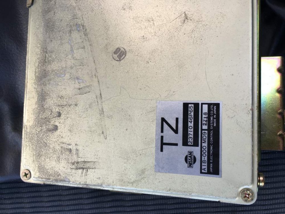

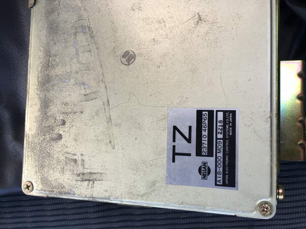

Rad refitted, also swapped out my standard ECU for this John Dixon/Zedworld/JWT ?? Chipped ECU for 550 injectors
Removed this
And fitted this

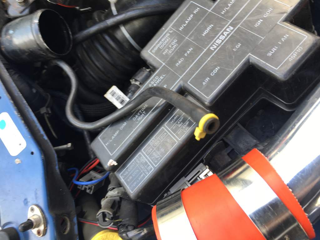

Pulled all the intake pipes and went looking for leaks, I've no turbo actuator hoses fitted to the I/c to throttle pipes, just two uncapped connectors, i don't think I'm able for pulling the whole engine bay apart to try and find the hoses, figure I'm going to pack it up for this year, save some money if I can and try to raise €1000 to ship it to Jimmer along with the spare TT engine. So fed up of the €1000's already spent on this engine, I thought the €1,800 parts bill and €2,200 garage labour bill would have put me in a running car, instead I got a car with an engine dropped into it with no ancillary connections. I've been doing it all myself following Write ups on here and Google but I'm just pissing against the wind at this stage. Nobody in this country wants to work on these cars, the ones that will, have zero Z experience and are just "Winging it". I'm going to sit down over the next few days and take stock of my situation.
Just slap the stock injectors in and get Lee or Jimmer on the phone and walk you through how to plug everything in. I think you just need it running at this point, for your sanity...
Man that is such a dilemma. I reckon is sounds like you are so close to having something running and I am sure the guys this side of he pond will be happy to help out where possible.

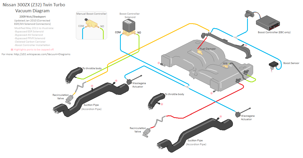

it is a total pain at times working on the z engine bay is not very nice really atall way to packed for my liking i know how you feel rite now i does get you down. anyhow just fit a boost control and you dont need all that stock crap much more simple
hook it up like this mite is set up like this before and after
bottom pic is the new set up top one is the stock set up

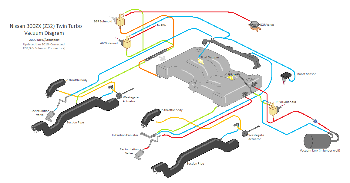

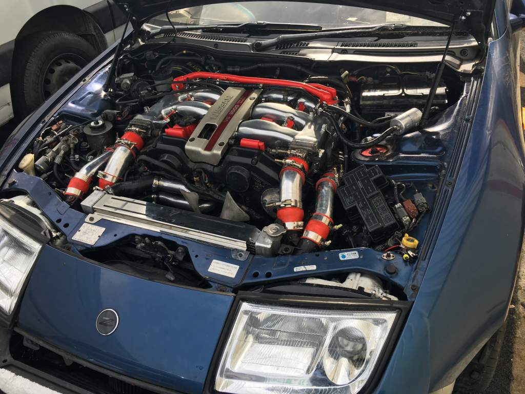

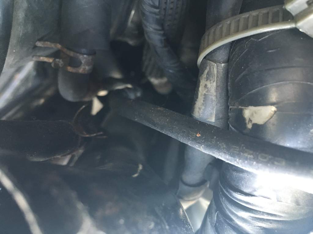

Haven't given up as such, I'm trying to do everything myself as everybody in this country is scared of that engine, they think it's too much of a headache to work on. At the moment, I've no turbo actuator hoses connected to the intercooler to throttle pipes, I can't even find the turbo actuator hoses, I don't want to pull too much out as I'm not a mechanic, I don't even know if the hoses are attached to the actuators:scared:. For me to get down to them, what do I need to do?? Pull the black intercooler to turbo piping?? I'm working in a yard with little room. What's the easiest way to find these hoses??
Go from underneath mate. The drivers ones a bit of a pain but the passenger one shouldn't be too bad, worse case scenario you will have to move the aircon condenser but I think you will be fine. They jut run from the actuator to the thin hard pipes between the intercooler piping near the rad, via the boost solenoid which are bolted to the sides of the plenum. Pretty easy once you know where they are and go.
Here's a pic of my engine, there's no hoses attached to the Intercooler piping, I've located where they're to go on them, the boost solenoids are under the black i/c to turbo pipes, this is correct??
I'll see if I can get under the car on Wednesday or Thursday, these are the days I'm hoping to get some lift time to fit the subframe and steering rack. If I could get a Z specialist and the use of a lift for a couple of days, I know I'd have the car running in no time at all:thumbup1:
