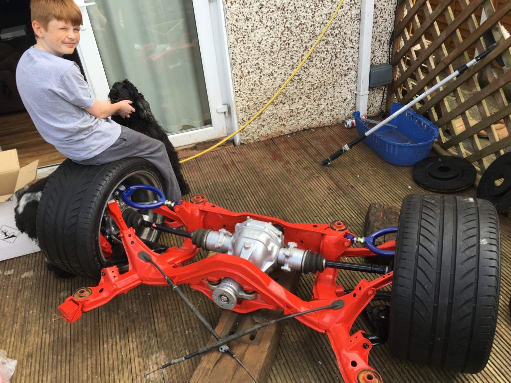

Rear subframe fully fitted up, just need to touch up some of the paint :thumbup:
Fitted up some adjustable rear upper camber arms
Will be going down to the garage in a couple of weeks for fitting:punk:

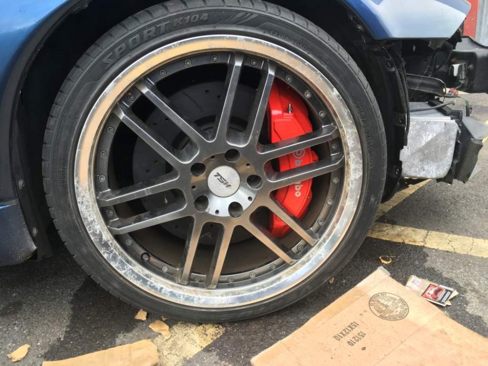

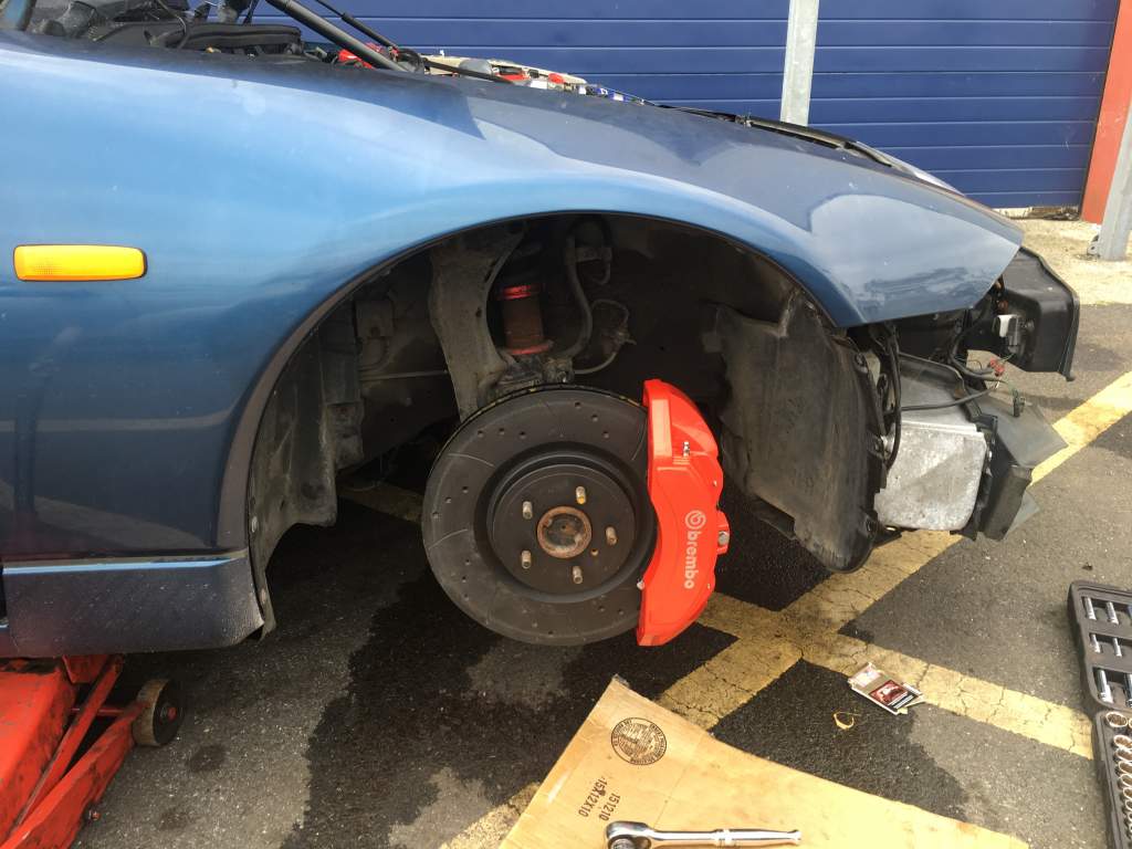

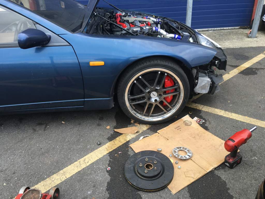

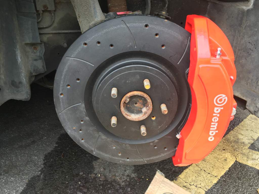

Went down to the garage an had a crack at installing the front brake discs and calipers
Had some trouble mounting up the wheels, got a loan of some 20mm hubcentric spacers and got the 19"s on but it's looking like I'm going to have to do something with the Veilsides. Not sure yet:innocent:
[ATTACH=CONFIG]101259[/ATTACH]
[ATTACH=CONFIG]101260[/ATTACH]
[ATTACH=CONFIG]101261[/ATTACH]
[ATTACH=CONFIG]101262[/ATTACH]
[ATTACH=CONFIG]101263[/ATTACH]
They're ****ing huge!

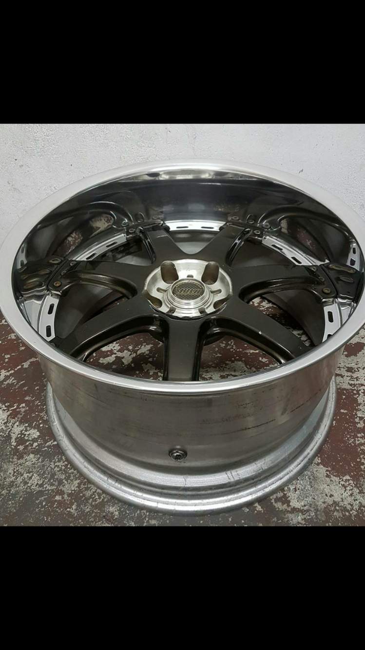

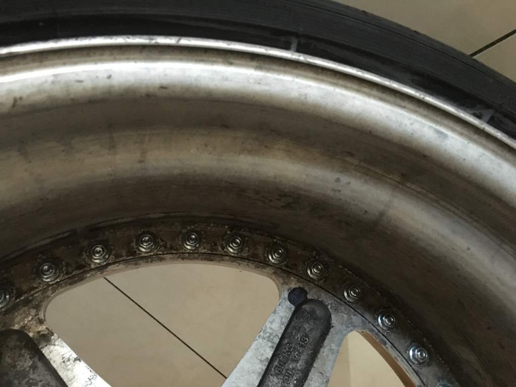

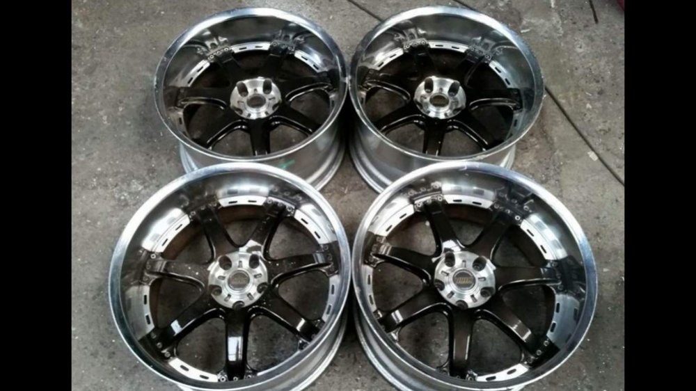

The Veilsides have a step in the barrel, I could maybe swap out the barrels for ones that are flat???
Here's a pic
If I could get a flat barrel and swap out the original with the bulge / step as pictured above, I might still be able to use them, other than that, I'd have to sell them for a different style of wheel:thumbdown:::scared::thumbdown: I really need to make these work, any suggestions??
Sounds like you might have to choose between the wheels and the brakes, Richie...!! :(

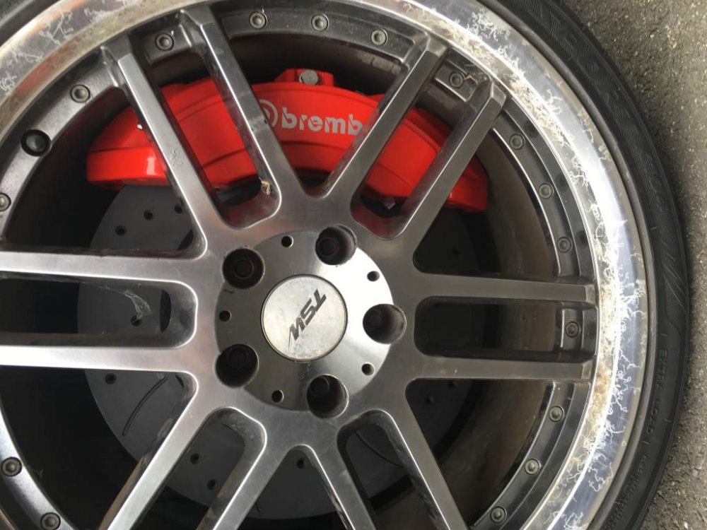

Rich,
Brakes look very nice. Question, are those 14" disks? If yes, that was the same issue I had when I tried to fit the 14" AP racing BBK on my Z. The Veilside wheels were made by SSR and they tend to use a step barrel on the inside of their wheels, even today; however, Volk/Rays Engineering uses a barrel without an inside step and those fitted the 14" BBK on a 18" wheel. I had to settle for a 13.5" disk so that my Blitz (which wer also made by SSR back then) fitted the AP racing BBK.
Hope this helps.
Rob
Thanks for the info Rob, I can also go for a step lip to 19"s, just need to see how much these options are gonna cost me, will hopefully be talking to my wheel guy this evening, think he's busy at the Irish Drift Championship this weekend:thumbup1:
If I were in your position I would try to find a barrel for the Veilsides without the step lip inside. I do not know how difficult that will be as that could also mean changing the offset on the Veilsides. It is all going to depend on what options are available for the Veilside centers. A good start for that research will be by counting the number of bolts on the center of the wheel and running a search online to see what options there are.
Rob
P.S. For everyone else looking to do a BBK upgrade on your Z please keep in mind your wheel setup, as some have an inside step lip and some do not. This inside step lip would mean that you can only fit up to a 13.5" size disk, where as a wheel without it would be able to fit up to a 14.25" disk.

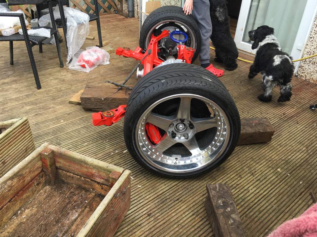

Problem solved !! :tt2::whistling::innocent::thumbup:
[ATTACH=CONFIG]101293[/ATTACH]
[ATTACH=CONFIG]101294[/ATTACH]
Don't tell me you're ditching the VeilSides? :(

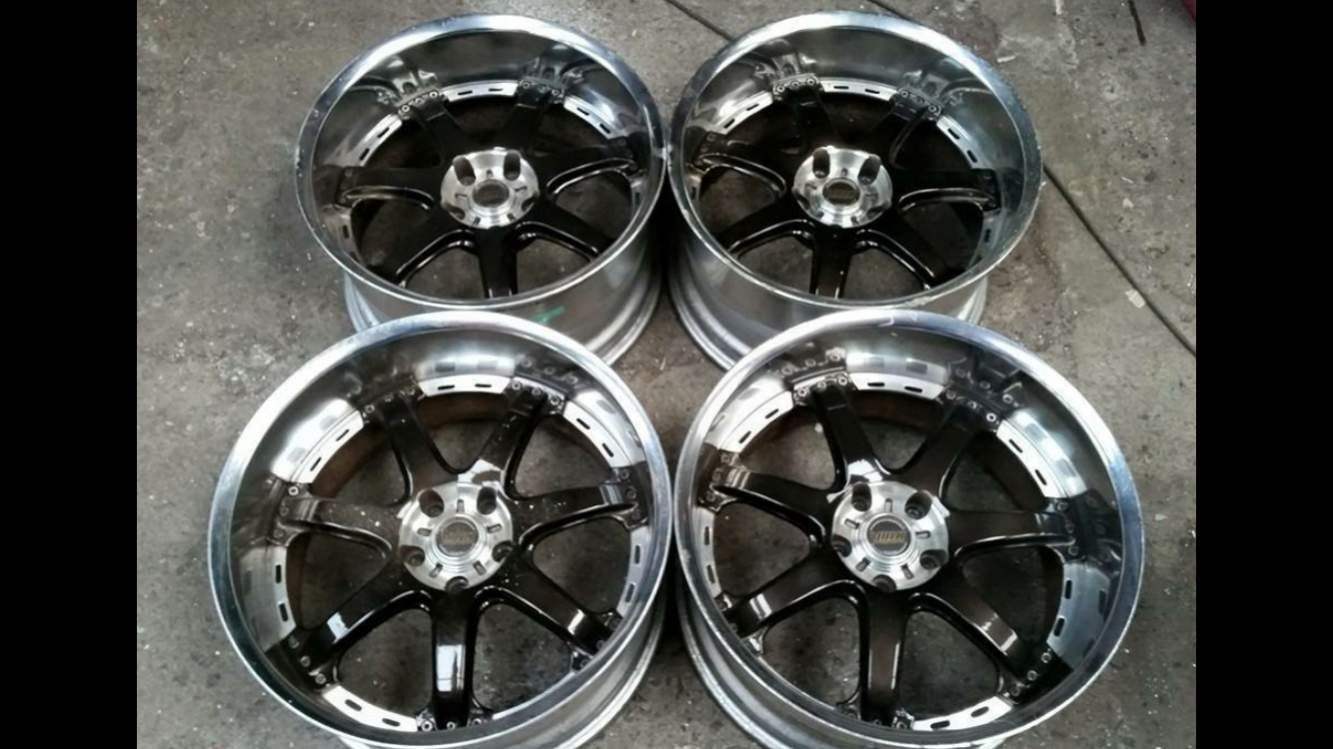

My buddy Brendan is going to call over at some stage, see if we can get the 10 x 18 and 10.5 x 19 Volks Racing GT7's to fit, he'll also be looking to see which barrels will make the two front Veilsides work, I'm definitely rebarrelling the Veilsides, looking at roughly €200 a side plus whatever Bren wants to build them. The GT7's are a set he has lying around spare, i can pay them off over a few months:thumbup1:

The Veilsides bud, that's the advantages of 3 piece wheels, I can change the lips and the barrels if need be to make them fit, going to cripple my finances for a while but it'll be worth it to have a nice set of wheels on the car:thumbup:
