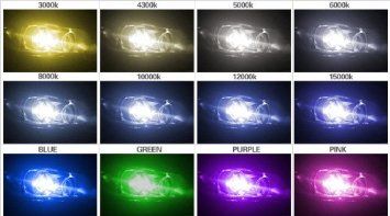

You want an h3 hid kit and around 6000k which is the colour here is a graph...

I got mine from ebay for about £35, had them a good few years and been great...
Many UK sellers have them now on ebay for less than £20, take your pick but here's the cheapest, you want H3 type bulbs, 55w power with colour between 4300k and 6000k, personally i always go for 5000k.
