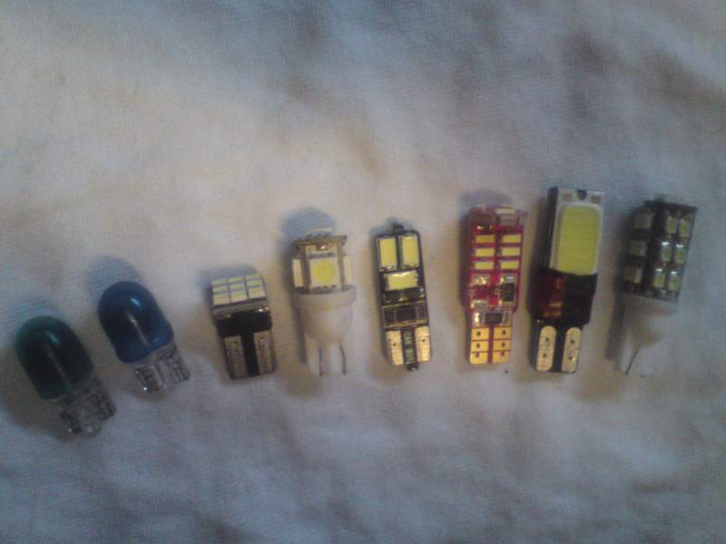

All were originally clear filament bulbs with coloured rubber johnnies on, these are shown on the first pic - the 2 on the left.
In this pic we also see some of the different types, some are clearly way too long, there are literally hundreds to choose from, all of these were bought on ebay from the far east.
The most recent i bought are the red boarded smd ones, it was in the back of my mind that they may be a bit long, lets not forget these clocks were designed with only short stumpy filament bulbs in mind but things have moved on.

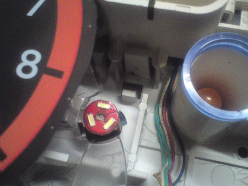

Here you see one fitted, please note the 2 x clear plastic diffusers that surround it, not this particular position but on at least two others the bulb fouled on them, too long you see, so all i did was either take a bit on the contact side off and/or take a bit off the diffuser itself with a small grinder on my rotary tool.
You want really a 501 bulb that offers 360 degree of light, the one 5th from the left does not offer this and these were fit until recently and in one of the four bulb positions i used the bulb 3rd from the left. If iirc 3 of the bulb positions have at least 2 diffusers that the light 'hits', in one position though - the very end on the right....just the one, the one where i used the 3rd from the left bulb.

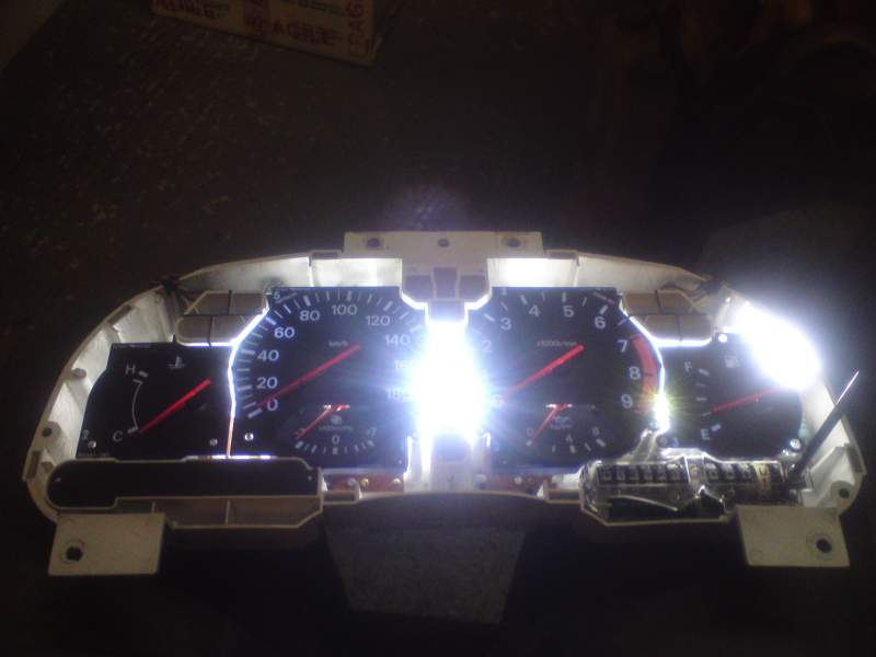

I am lucky as i have, with tails, all the multi plugs so i can test like below and play about :).

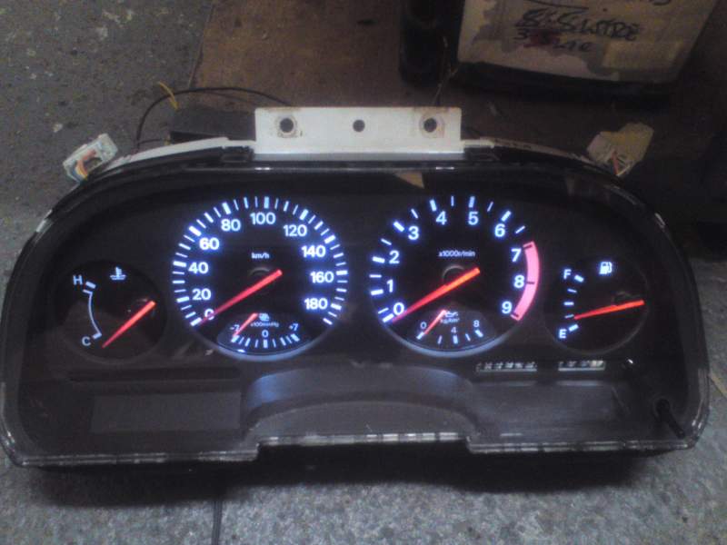

I did get as you'd imagine finger marks on the dials, i just fingered on/gently rubbed some glass cleaner and these disappeared and/or evaporated away.
All done and these to me seem brighter, again my camera is picking out the bright spots but to the human eye these are crisp, even and white. Of course it's up to you as you may desire red or blue bulbs but personally atm i'm happy with white.
One of the main things i take note on pictures of other peoples clocks, are how poorly lit the needles are but i seem to have all these uniformly illuminated, i will fit to the car and update further.

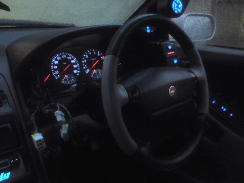

I have fit into the car and i'm well chuffed with them, i cannot tell anyone to get the same exact bulbs as they are not a straight fit.

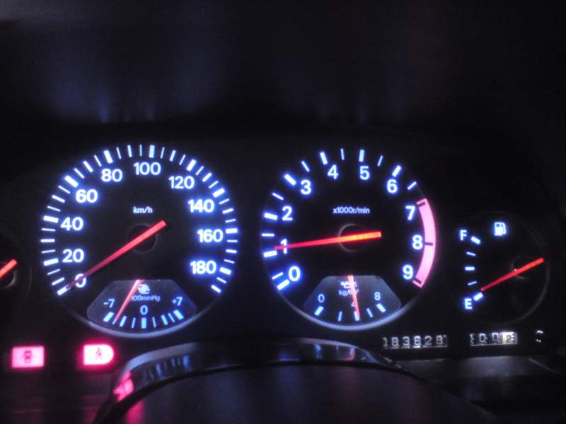

I feel i owe this thread a far better pic, the video i have done is truly awful and both on that and the earlier pic i think the battery voltage was not what it should of been.
So after briefly charging i started the car up and i hope this below is better, these white bulbs are bright, bet your odometer read is not as well lit but i'll be honest i have got out some (run of the mill) red and blue bulbs to maybe fit, whether i find them bright enough.......not sure but as suggested and i am well aware one of these colours will match better my colour scheme :cool:.
