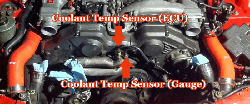

The problem is simple, the temp sensor cable at the front has been disturbed when you did the plug change, this now is been seen and a fault by the ecu and hence fuelling for a cold engine flooding the plugs and triggering the electric fan, so check the connection, clean and reseat. Oh and do not put those iridium back in, they do not suit the V6 engine well as they tend to not self clean enough, the original platinum NGK PFR6B-11C are the ones to stay with.

Thanks guys, I'd been reading through this http://www.twinturbo.net/nissan/300zx/tech/auxfan/auxfan.html and had come to the same conclusion!
I've just been out and reseated the connector, spades were very green and now the fan is off and the car seems much happier, thanks guys! I have recently replaced the drive belts and I think I probably knocked it then.
