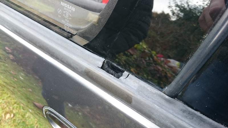

Firstly, the window seal. Appears to have been hacked at some point, possible attempted theft in the past~?
I'd like it replaced, maybe both sides to match?

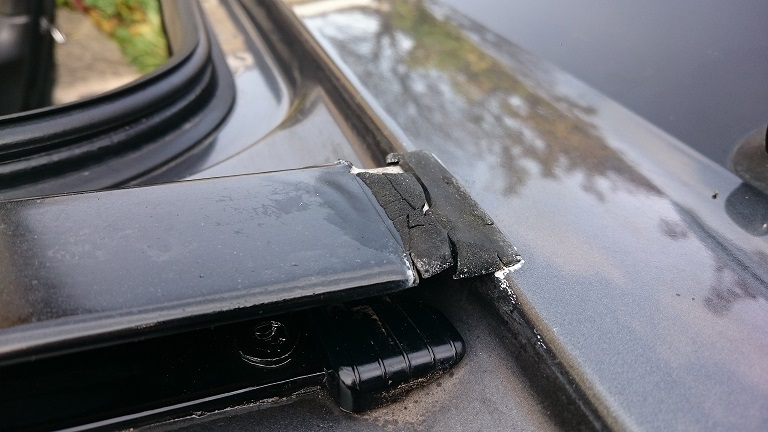

Then there are the roof seals, is there anything I can do about these or would this require replacing to?

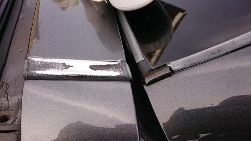

The T top rubber has seen better days...

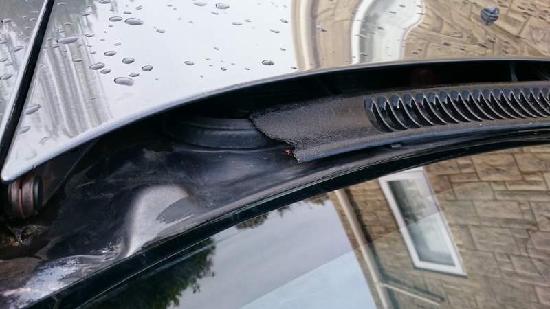

And lastly the front bonnet vent, seen here, has been snapped.
For the roof seals, i suggest either rubbing it down and black plasti dipping it, or just strip it down for a chrome look. I'm sure one of the people breaking a zed on here can send you the T-top rubber ,a bonnet vent and the window rubber...

Window trim damage is not cause by attempted theft but the dome head on the glass that goes passed the rubber strip, ok when the strip was new but once it goes hard the dome head tears it.
Jeff

The two small roof trims are cheap at about a tenner each but will look way to clean next to old targa trims.

I'm sure you will get a better targa centre trim used but they do require a bit of work to replace, about £80 new if I remember correctly

I'd like to do something about the gaping hole in the window seal though, maybe a second hand one.
Jeff
