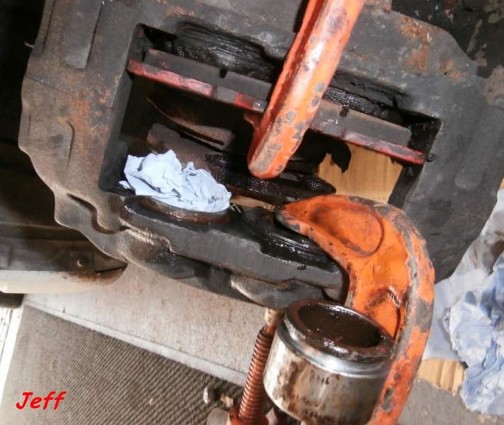

So take a look at the pictures what you will need to do is set your self up with a couple of G clamps, a bleed tube and a hose lock off clamp, also a big tray.
The method is simple enough, to use the brake system power to force them little buggers out of the caliper, now this can be done on your own but its much better to have two as you will see in a moment when dealing with particular stubborn one`s.
1) Ok fast forward to jacked up wheel off caliper off and disc off, now bolt the disc back onto the hub to hold it, lock off three pistons.
2) Unclip the outer dust seal snap rings, most likely these will be ripped and part of the problem, spray the inner seal face and piston edges with WD40 or similar.

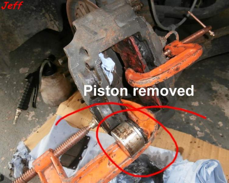

3) So pressing the brake pedal is designed to push out the now single free piston, if it is seized it will require a lot of pushing, sometimes you will need to start the engine to help. Take it in several stages and it will come slowly and if not, do not worry, open the bleed nipple and put the pipe on into the tray, lock off the brake pipe clamp, this is important so no pressure goes back up to the master cylinder because it can flip the seals on it. With the nipple open and the hose locked off now use a pry bar against the piston to push it back into the caliper a bit, close the nipple and release the lock off and get the assistant to press again, a combination of pushing and pressing each time locking off the hose and opening the nipple will eventually release even the hardest piston.
4) So when it pops out and it will a fair bit of fluid will come out so hence the tray, put the hose clamp on to stop this.

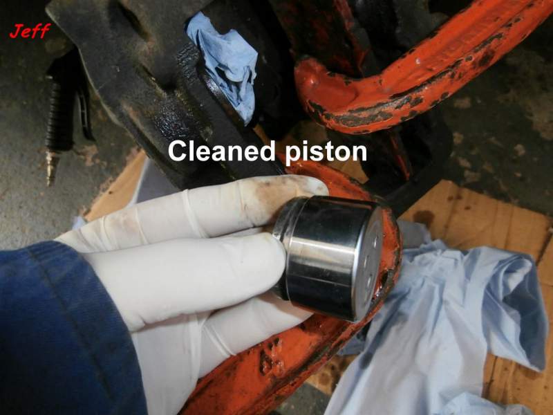

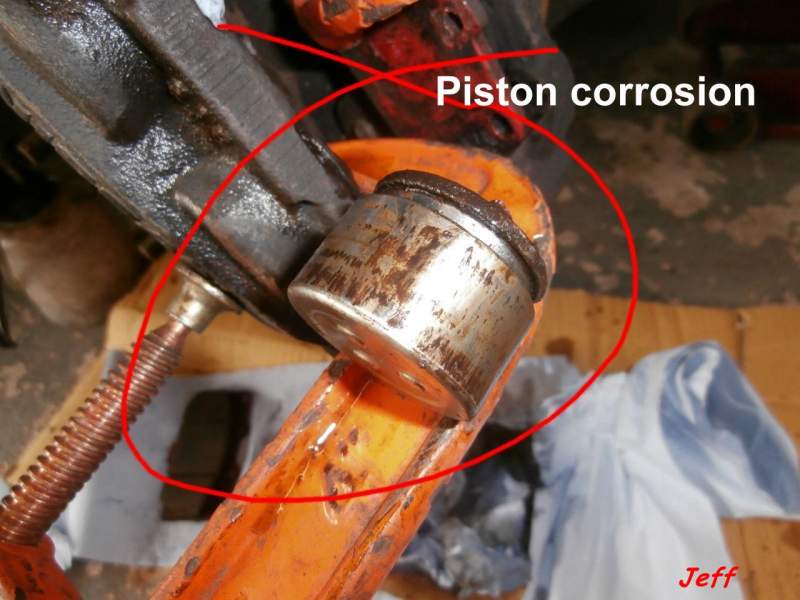

You can now deal with the piston, it will look corroded and dirty but all it needs is cleaning off, that little bit of rust film is enough to make it stick in the seals.
5) Cleaning the piston is quite easy, get a damp cloth and wipe over, then with some T cut, its very slightly abrasive of course and will work magic on them, after they are cleaned up wipe it clean and put aside.
6) So now the harder bit, looking inside of the caliper there is seal that needs flipping out, use a small screwdriver VERY carefully no scratching the cylinder bore, stay within the seal recess. Once removed clean out with a clean cloth and almost certainly the leading edge will need rust cleaning off, this I normally do with some wet and dry paper, say 800 grit, this is a bit boring and makes your fingers ache but hey ho all in a good cause when all is clean and included in that is the recess that the dust cover snap rings fit in it time to rebuild.
