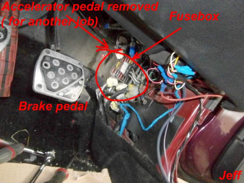

Hi can anyone tell me were the Fuse box is for the cigarette lighter I done a search on here it say driver side footwear I had a look but can't find it unscrewed the cover below look like heater tube any pictures would be handy thanks Stephen
In the drivers footwear next to the acceleration pedal. It's quite far back.
It's just a pull off panel. It's awkward to play with the fuses...
Just to be helpful here's a picture of the panel
Here is a picture of where it is, it actually shows the accelerator pedal removed but that was for another job and not for just fuse checking, there is a plastic panel normal in place hiding everything and a smaller panel is removed to reveal the fusebox.
Jeff

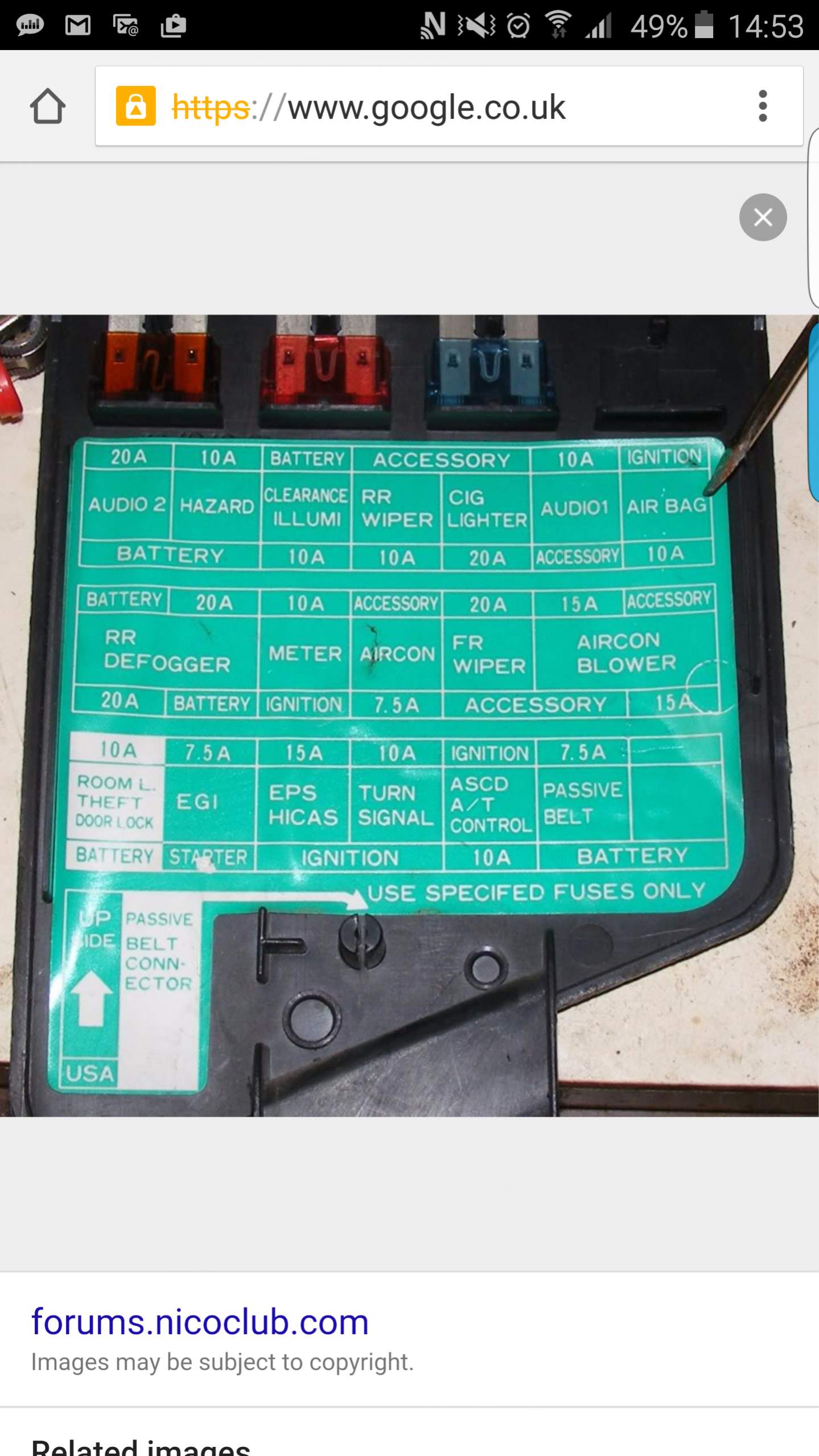

Just save that image. Thanks. Mines in japanese and i don't have a clue haha
