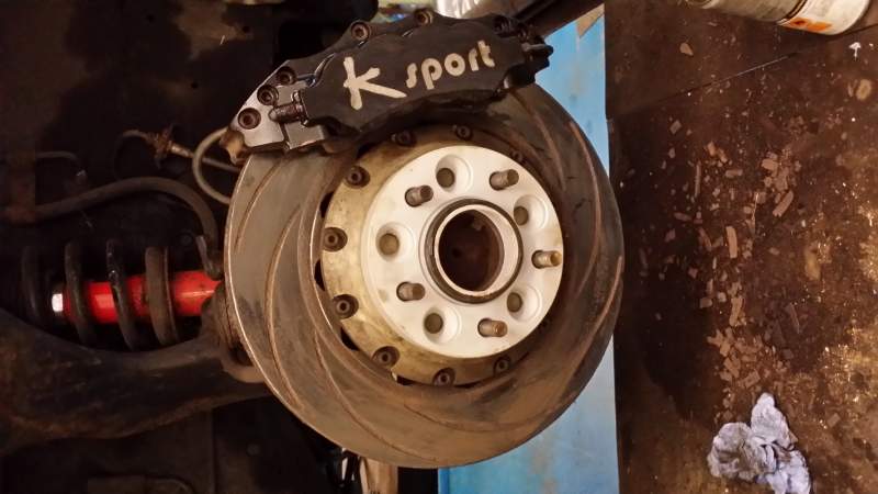

Hi, I was removing one of the front wheel spacers that are on my car so I could remove the discs and a nice chunk decided to break away (seem to be cheap alu ones)...
I would like to replace them with some of a higher quality but am unsure of fitment.
Current setup is:
-Advan Siena II Wheels (18x245x35 Tyres)
-K-Sport 8 pot Kit (330mm discs I believe)
-20mm Spacers (made from chocolate aluminium, hubcentric slot over type)
I am unsure what type I would need. Not sure if the hubs have standard studs, possibly the studs are elongated type? If anyone knows the standard length that would help.
I have seen these Eibach ones on eBay, I believe the 350z has the same specs as the 300zx but not sure about the bolt on type. Should these fit a standard stud and flush fit with the provided nuts?
http://www.ebay.co.uk/itm/Eibach-20mm-Pro-Spacer-Hub-Centric-Kit-350Z-Z33-S90-4-20-003-/321871804536?hash=item4af10df878
Cheers, Adam

I love the wheels Si, don't think I'll ever change them!
The only issue I think I'll have with the Eibach spacers is I'm sure the current studs have been replace with longer ones, leaving me with 25mm thread protruding (with the existing spacers fitted).
Roadrunner have got a set in so I can drive down and have a look but would there be any way around this if they are too short, apart from going down the traditional slide on spacer route?

Right I got the eibach spacers, got them home to find it the studs are a different thread to the ones fitted to my hub!!!
Pressed the studs out of the eibach ones and just using them like normal spacers. At least it's a step up from the tin foil old ones
Cheers for the help everyone, another step closer to being back on the road!!!!
Did you pick up Honda ones by accident?
Thread pitch on a Nissan is 1.25. Honda and a few other Japanese are 1.50
Or you don't have OEM studs currently fitted.
No seems a previous owner has fitted non oem extended studs. Car was on ramp at mates garage so didn't have time to order new studs and one thread is fouled badly at the bottom, so cutting those down wasn't an option unfortunately
