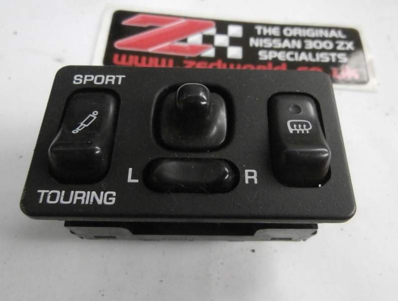

Here is a picture of how the the guys in the US had their electric dampers switchable.......

Thanks Jeff for that info. It appears that I can get a pair of rear shockers from USA ebay for cheaper than buying here and that includes shipping and customs charges, bizarre!
