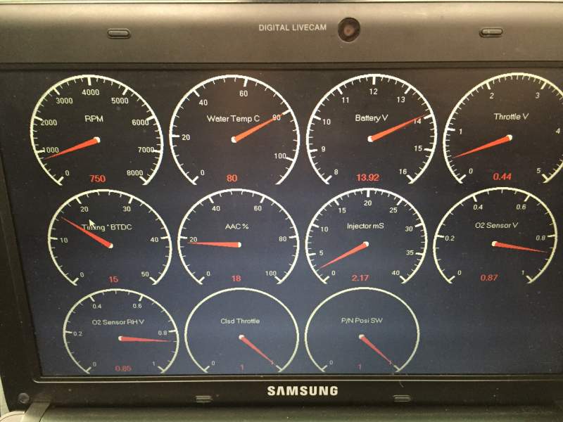

- one/both of the O2 sensors sit steady at 0.8v at idle- raise the revs a bit and they dance around as they should ( brand new Bosch)
- the car smells rich at idle- on the mot test, Co came out around 1.75% (too rich I think)

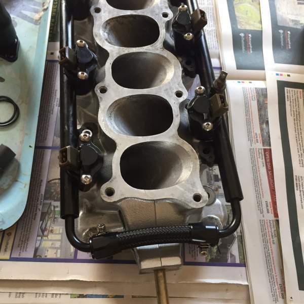

Before installing the injectors I ultrasonicaly cleaned them and installed new orings
In my haste to get it back together I did not clean out the (new)fuel lines- this already caused a blocked injector which I sorted and it ran well after that.

I converted my fuel rail to -6 fittings and I'm running an aeromotive FPR with gauge

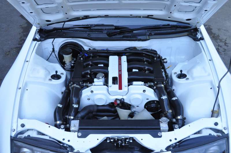

My engine bay is very minimalist and I have removed as many (in my opinion) unnecessary parts as possible for both an asthetic and simplification/reliability.
I did plenty of research on this obviously before doing so
It currently looks like this
Wow that looks amazing, what fuel pump you running then? does it smooth out the typical pulse feed?
