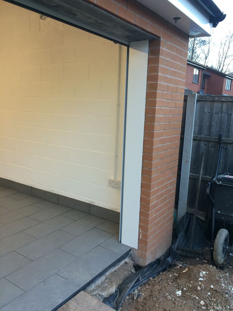

We use Tiles in both showrooms here Simon mate, I can try and find out who supplied us if you want. We haven't had a tile crack here and we have had very heavy vans on them.

The tiles we have are 300x600 Porcelain and were supplied by a company called Fiandre
