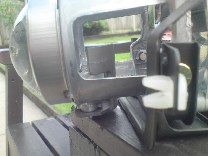

It doesn't have to be new headlights, slap bang in the middle of the pic below there is deflector or shield, this is all you need to make yours RHD.
I can send you a pair and they just screw bolt in, you will need to pull the projector out but this is done with the adjusters until they just drop off the thread, so you'd replace after you've removed the glass and strip them down to clean, etc, anyway.
I can also send you the 8 x Tamiya metal cogs needed for the adjusters.
Let me know if you're interested in this option, delivered i would want £35.00.
Cheapest is to swap the shield, or grind your current one flat. But that means your adjusters have to work so you can adjust it down afterwards... I take it flat beam pattern is allowed in the UK?
Many people did this mod to skylines being registered in Scandinavia to get headlights legal...
