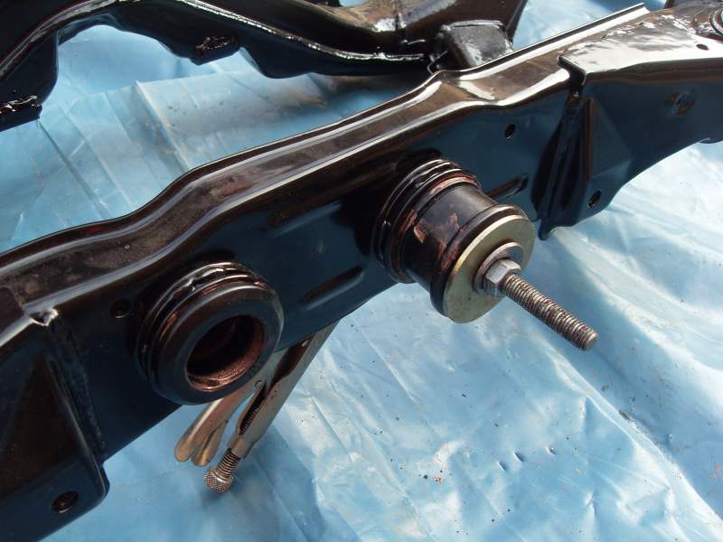

this is a pic of when i did mine hope that helps [ATTACH=CONFIG]89247[/ATTACH]
then wind the nut in and the bush will go it it did take a few goes but did go in, you need some stub big washer 2 nuts i also put a socket inside the bush so it wouldnt destort as i wound it in

Ok thanks I thought I'd have to knock some sort of puller up .
just a bit of stud works fine
