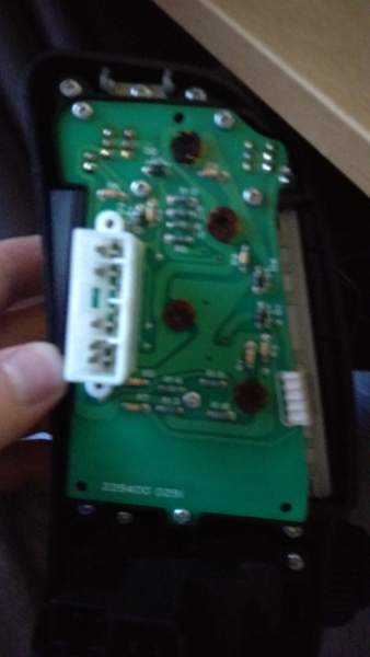

Followed this guide today, but the circuit board and its electrical contacts look perfect. The clicking comes from all over the dash so it's not any clearer.
Also, the circuit board is different to the one in that thread.
