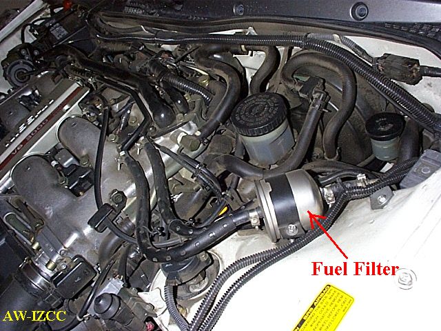

note : i noticed that i don't have fuel filter in my car.

As Gary said, sort your fuel filter out.
