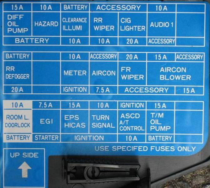

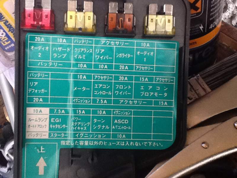

for the drivers footwell fuses, mine were all Japanese so I have this to translate them.

This happened to me mate. with me the fuse went which is named clearance illumination on that diagram. That had gone and so I was getting odd lighting like you :) worth a try

The diagram shows 4 fuses relating to the lighting system, I can find 3, 2 in next to the relays and one drivers side footwear.

Ur showing a fuse/relay box under the bonnet not the one in the drivers footwell!
Have u checked the 10A fuse Tomfromthenorth has suggested?
The fuse box is covered! U need a light, get on ur knees & look to the right of the accelerator peddle in the drivers footwell.
Take the cover off & there are fuses under there! Top row 3rd fuse in is a 10Amp. Check it!
If ur lucky enough like mine it glows, if it's an ordinary one it won't & u need to take it out & look!

My cover as an import is in Japanese !
[ATTACH=CONFIG]87469[/ATTACH
Checked that fuse its fine
