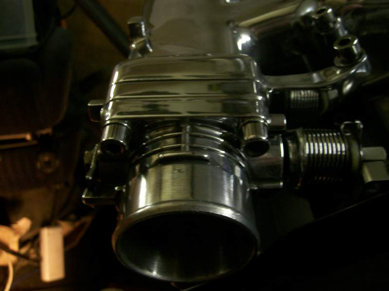

[ATTACH=CONFIG]87434[/ATTACH]
I seriously need to find out how to do this!! That's some fantastic work !!

Lots of youtube vids on how to polish lol, its just so time consuming when doing the plenum, other stuff like water pipes and smaller parts is not so bad, but the hardest part of the whole polishing engine parts job is keeping up with the finish. You have to set aside some time per week/month, to keep the shine.
There are a couple of types of systems to use, the metallic composition to take into consideration, eg steel or ali etc have different make ups in chemical compounds and how these are affected when polishing.
Prep is key and the smoother the finish before polishing the better result achieved :thumbup1:

Dremel is only good for nooks and crannies, originally i bought a whole set of sisal and buffing wheels to mount on a drill, the speed needs to be fairly high, then exert some pressure, the dremel isnt strong enough when you put too much pressure.
I will start another thread lol on how i did mine and the new system i bought at the NEC to stop clogging Si's thread further :thumbup1:
