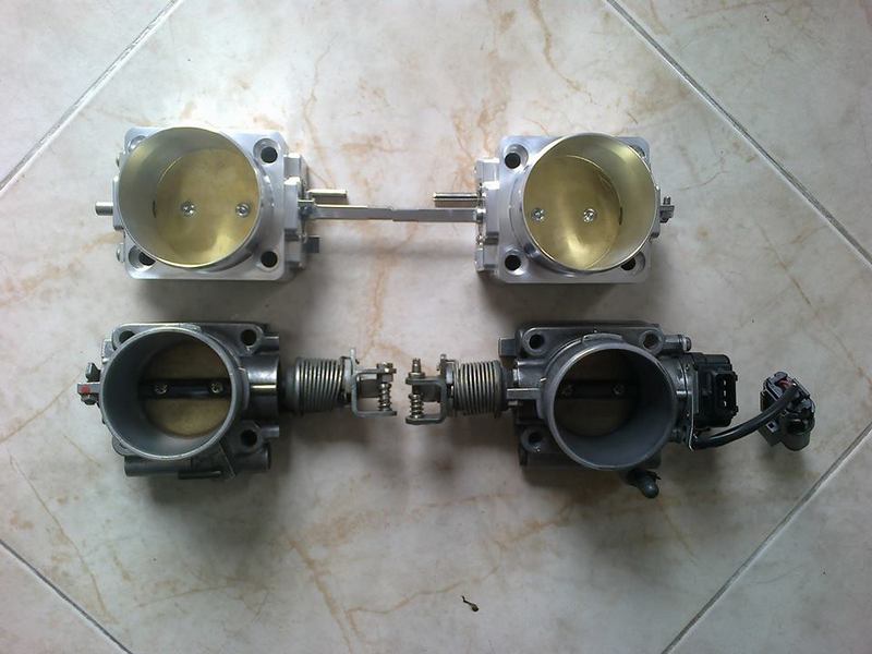

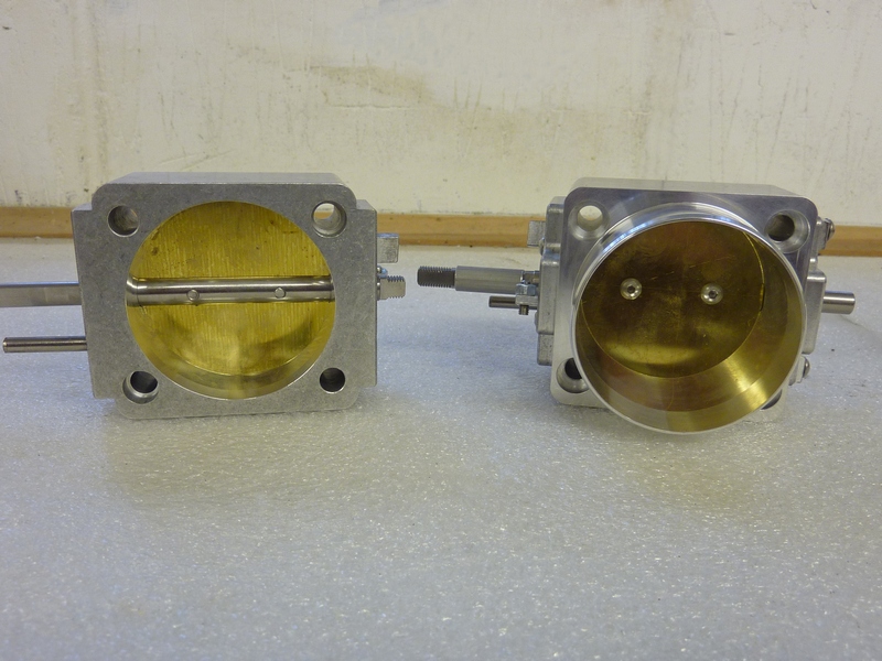

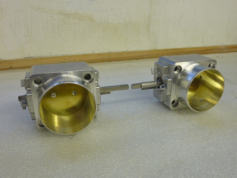

These bad boys turned up this week from the States - 62mm billet throttle bodies designed and manufactured by Robert Bastian.
They are fully CNC machined from billet aluminium and are beautifully made. They have proper shaft seals (no leaks under boost)
and the butterflies are a perfect fit when closed. They need the return springs and stops transferred from OEM throttle bodies and
the intake manifold will need porting to the larger 62mm bore. They will be installed along with AshSpec SMICs and 2.5" IC pipe
work in due course.

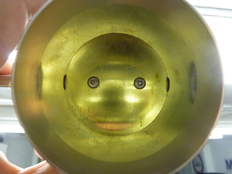

Held up to bright lighting:

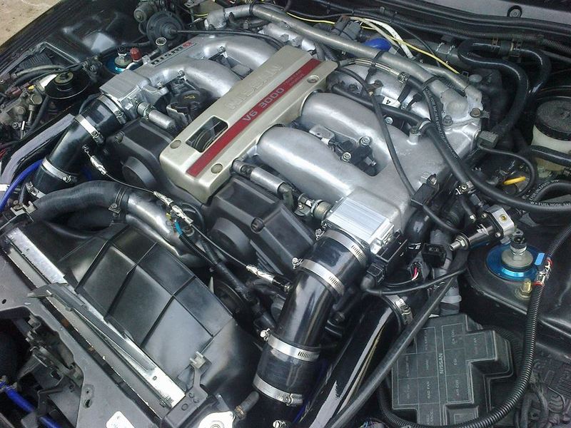

By way of illustration, this photo shows another car with the 62mm throttle bodies fitted (along with AshSpec IC pipe work):
