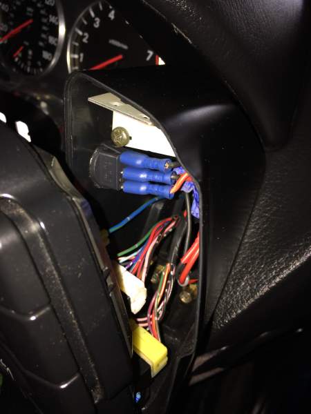

I've been told to open the cruise control pod and attach the wires then, but I'm not sure where to, can anyway that has a 1993 Jap TT tell me which wires to use?
I have attached a pic of the area I'm planning to use, just need to figure out which plug then which wires.

you need to get your testers out and find which wire goes live when you put the ignition on and the light switch turned to the first stage ( sidelight, ) or read the schematics and narrow it down , its not hard just take your time and work through them methodically,
So for clarity ring each wire on each connector looking for the wire that reads zero with the light switch off and 12 v with the light switch on, then tap into that for your live and run the ground to anywhere that will give a good ground on the body of the car,
That mightn't be the best location to do your connection, there isn't a lot of room to work in & the plastic mountings are easily broken.
Look for a GREEN wire with a RED tracer, that's an illumination wire.
Where is better?
The ignition ring light feed is longer and out of the way and easier to tap into, need the kick panel off then the binnacle to slide the ring off the barrel, there you will see the bulb holder on a wire tail, strip back both wires an inch or so away from the ring, then you have a chance to try the pod gauge light feed to determine which wire is positive.
If you dont want to cut any wires and have some time, get down to the bottom of the dash and the two prongs at the bottom are a light feed, left one as you look from the front is positive. Use a couple of ring crimps on the end of the wires from the pod gauge, undo the two screws at the bottom of the dash, and replace screw with the ring attached:thumbup1:
I have as much time as needed mate :)
Do you have a more exact location for these two prongs?
Here you go mate, the two screws just above the palm of the hand in the pic
