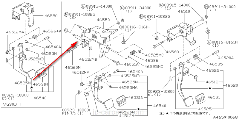

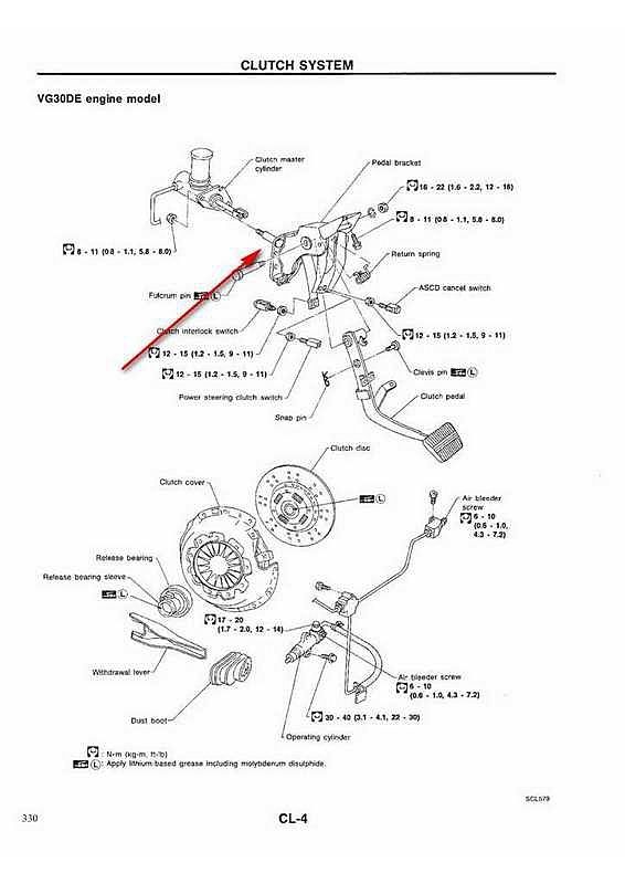

Did a bit of research for you. I think LHD and RHD brackets are different. The two images below show the
differences - the most significant seems to be the clutch slave cylinder to bracket mounting bolts. I've indicated
this on the diagrams. I'm not sure which diagram is for LHD and RHD, but I suspect the CL-4 is RHD. You could
compare your bracket against them.

I have the same diagram (CL-4) in my FSM and my firewall stamping matches, roughly, that configuration. However, when I look up any Nissan part # (LHD or RHD) I get the second diagram with the reversal of the bracket-firewall-master cylinder bolts.

I think Nissan's parts listing may just use a generic clutch bracket diagram simply to indicate correct part numbers but not the actual shape of the part.
