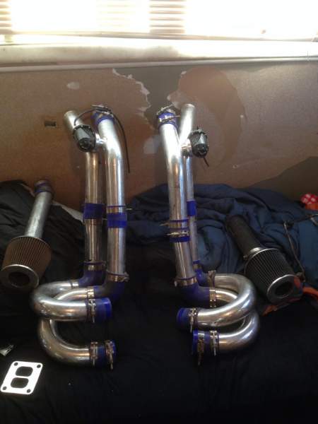

Now question one. I know that the pipework on each side of the intercooler must look differnt and not semectrical.
And the other question will it be ok to run with larger pipe.? As im going to do this with 2.5". Im not doing the maff side yet as i know when i finish that it will need a base chip untell noel gets to map it.but i think it should be ok to do the intercooler side.just checking. Cheers.
So many posts! Attempting to answer your questions, you should try to keep the lengths as similar as possible each side. Going to larger piping generally will mean it will be slightly leaner and you should have the tune checked
Cheers jaffa.keep them as short and even as possible.and i pusume swap the banks over. Cheers
