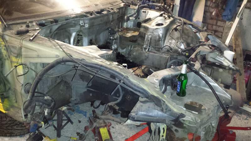

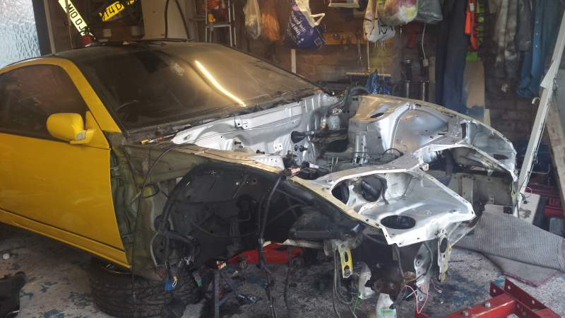

I've started on the engine bay, I've only taken reference pictures really, as there's a lot to refit, but I will start to take progress pictures too. Lots, and lots to do. Not done that much really but I only started a few days ago.
After stripping, before a clean...
After a clean...
The photos are bobbins, and I'm using my phone for this and it is getting on my wick, but I'll take plenty as I'm doing her (ahem). I've got my front subframe, suspension and an NA rear end at my workshop degreased, almost ready to be painted and a few bushes replaced.

Mine hasn't got a beer bottle in the headlight bay !
Is that an optional extra ?
Haha, it is actually a bottle of Becks Blue alcohol free :(
