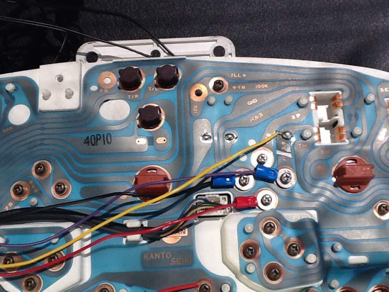

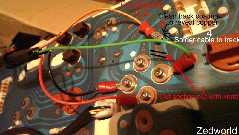

take the filter out and check the level ... as the filter can fool ones self in thinking there is plenty in it
other than that check your wiring on the dash clocks
are you running an import with a speedo convertor ? when they let go and fail , that is the symptoms you get ,
Been driving it today and things seem back to normal, so maybe it just needed a bit of use after being out of action for a while, I am interested in the references to the wiring on the dash and the speedo converter on an import (which mine is)?
