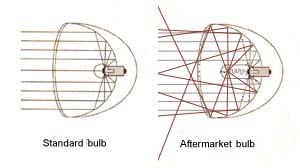

I always understood it that LED bulbs required a special lens to produce the required light output. Simply putting one in a halogen or projector housing wouldn't necessarily have the desired results.
I'm always open to be being proven wrong, but that's what I understood.
yeah you're right, same goes for putting an HID kit in but everyone seems to put them in ;) even with a realignment there not technically legal. im working on putting HID's in my main beams :P
Looking at the bulbs side by side, the focal points are completely different between the two types (Halogen and LED).
The LED may produce more 'light' but it will not be focused in the reflector in the way it was designed for a halogen lamp.

Correct, regarding the focal points. I've seen guys try to stick LED bulbs into the Z32 project and it just doesn't work well at all in regards to focal points.
Further many LED headlamps require the use of fans or heating film/lines (similar to the rear windshield) to work properly. Traditional headlamps, throw heat forward and away as infra-red radiation, LEDs need to loose heat by conduction from their rear by semiconductor-style heatsinking. With no heat at the front, LED headlamps can freeze over in icy weather. The solution is to use a fan, allowing a smaller heatsink, and get it to blow heat over the front glass.

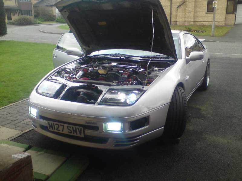

Having given these a good testing on an incredibly rare drive between midnight and 2am, I can conclude they are no brighter than my H3c hid's, fitted with 99 headlight inserts, in fact all I see when I flick to main beam is a pointless hardly noticeable light at each side.
In fact on the journey I didn't need the mains at all (just as well!!) as the dipped were more than adequate, I also have hid lights in the fogs and these are amazing and complement the dips incredibly well, when on occasions I hit the pod button.
When I had stock 55w filament bulbs fitted the beam did project further than my previous set of H3 hid's, fitted with 89 inserts.
Please note and it's not a typo, that I have now H3c HID bulbs fitted, previously it was H3 bulbs, both with the same 55w ballasts. I have no conclusive proof that the H3c bulbs are better but you would expect so being stock length.
Also note I have adapted my lights with the diode modification - meaning when i switch to mains the dips do not extinguish as they would unmodified or in stock form.
Therefore, as I don't require the mains for distance and until something else comes along I am keeping the led H1 bulbs in there, they're very white, immediate, bright enough for flashing and I expect will satisfy a tester.
See the pic below, not the best I know as straight on would of been better but you get the idea, they basically look like I have another dipped beam :biggrin:.
